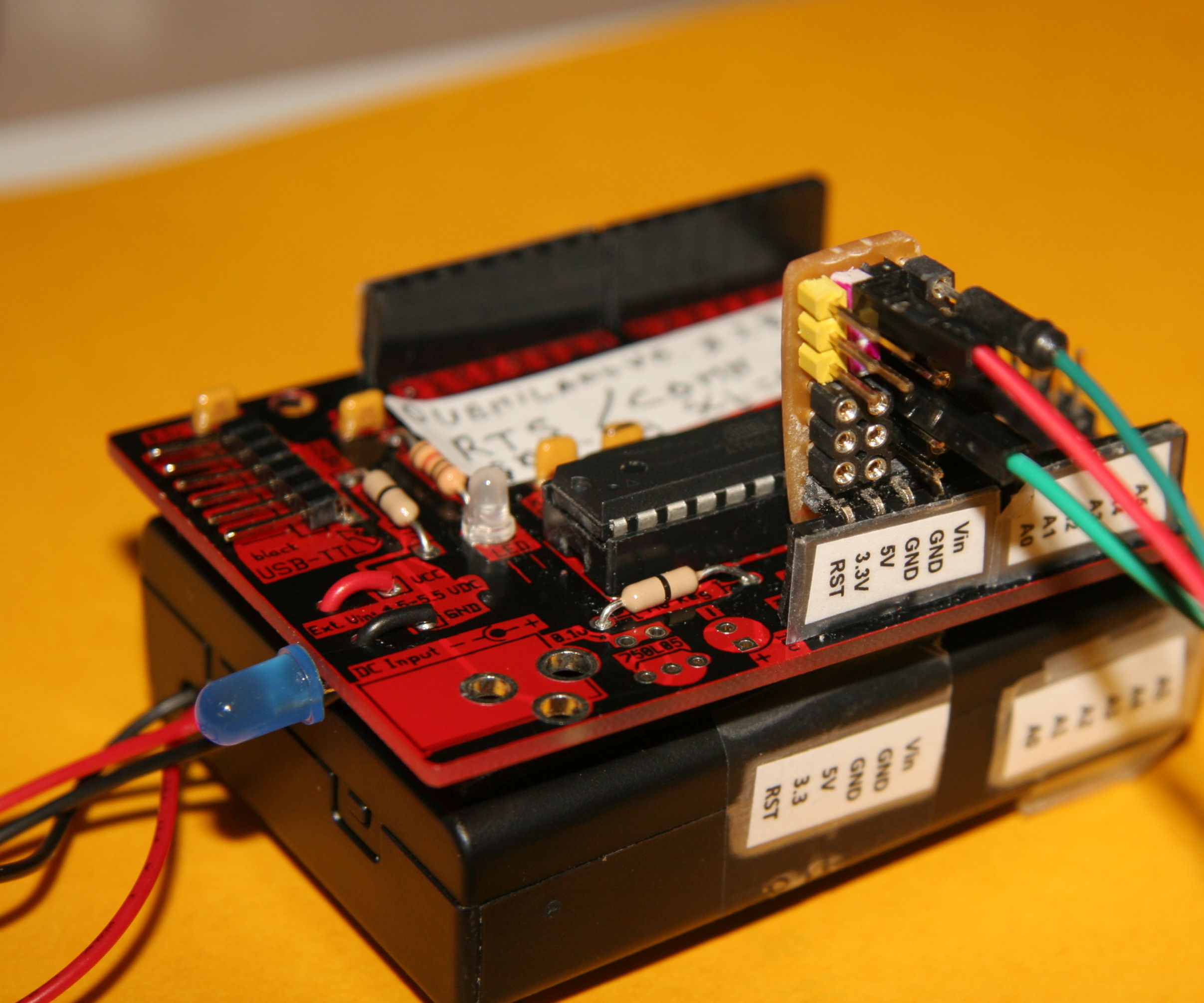

What this instructable is about is making pin labels for Arduino and projects. I have included a printable page (use Inkscape to print it) that will let you print pin labels for the Uno, mini and a Duimilanove clone from Mad Scientist as well as the AVR mega and tiny Chips, very useful for when you have an Arduino on a bread board.

Your pages can be printed on a laser or ink jet printer on any kind of paper or even plastic see the articles from Nuts and Volts. I have found printing in black on the laser printer using colored paper looks great. If using an inkjet printer, be sure to use inkjet or photo paper or the ink may run, with the tiny letters this could make them unreadable.
Once you print the labels out and before you cut them out cover them with transparent tape or clear plastic of some kind to keep them clean. If you can find it clear contact paper works great for larger labels.
To attach tiny labels try a glue stick just run the label over the end of the glue stick and stick it down. You can move it slightly until it dries. Tweezers help a lot with small labels or if there is not much room to glue them down. For larger labels and project panels I use rubber cement.
