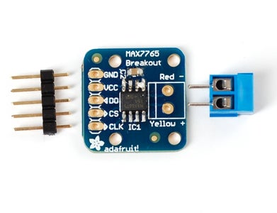

At first you can get this module form adafruit or you can get a chinese full kit of this module with K-type thermocouple included for less than 10$. They are all differ in shape but works in the same way.

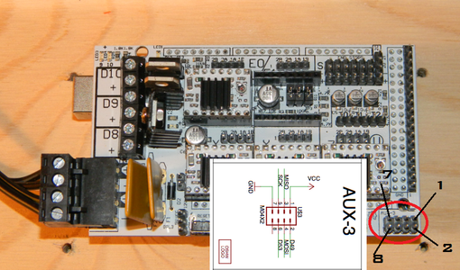

MAX6675 works under SPI communication protocol so you need to connect it at AUX-3 on the RAMP (the same connector for the SD-Card)
Note: you still can connect your SD-Card module while using MAX6675 and the controller (MEGA) will choose which one to communicate with, but you have to figure out how to wire both modules together on the same connector.
Connections
- GND on MAX6675 goes to GND ( pin 7 ) on RAMPSAUX-3
- VCC on MAX6675 goes to VCC ( pin 1 ) on RAMPSAUX-3
- DO on MAX6675 goes to MISO ( pin 3 ) on RAMPSAUX-3
- CS on MAX6675 goes to D53 (pin 6 ) on RAMPSAUX-3
- CLK on MAX6675 goes to CK ( pin 5 ) on RAMPSAUX-3
Note:
-some times you can find pin DO named SO and pin CS named SS and pin CLK named SCK in different MAX6675 modules.
-If your connection doesn't work, connect CS pin on MAX6675 to D49 ( pin 2 ) instead of D53 ( pin 6 ) on RAMPS AUX-3
