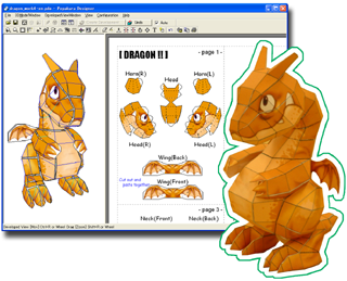

 Pepakura (often referred to as "Pep") is a program that creates buildable papercraft models. Using 3 dimensional data, Pepakura allows the model to be unfolded to a flat template to be cut, folded, and glued together. Pepakura accepts a range of 3D file extensions, and can save files in its native extension (.pdo).

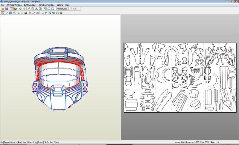

  4. From here you should see two windows. The one on the left is the 3D model you opened. The window on the right is where the unfolded pieces will appear.

First, get rid of the 3D window, so that you will have more room to re-arrange the pieces. Select the "Configuration" tab, and click on "Show Only 2DPatternWindow".
To space the patterns out, you'll need to use the "Select and Move" tool. You can select it in the right-click menu. Now, arrange all of the piece so they all fit on the pages, and don't overlap. You can put as many pieces on one page as you can without overlap, but some space aids in cutting it out.
