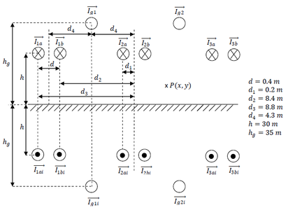

The situation I'm analyzing is a transmission line, 3-phased, 50 Hz alternating current power line considering a voltage of 400kV and a power of 1200MVA. Each phase is composed of 2 conductors ("bundled" 2 ways). There are also 2 overhead earth wires or shield wires on the top of the tower. All the important distances are represented on the previous image (in meters).
The section being studied is an area perpendicular to the length of the conductors, considering 40 m for each side from the center of the tower (on the X axis) and a height of 50 m from the ground (on the Y axis).
The electromagnetic field, as the name says, is made of 2 components, the electric field and the magnetic field. This work will analyze them separately in different time instants.

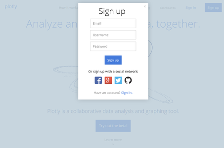

First let's create a plotly account, it's easy, it's quick and the best of all, it's free! Go to their website and sign up for an account.
When you've created and activated your account you're ready to go!

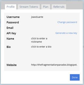

To be able to start sending data to your plotly account from an API, first you need your API Key. Go to your profile settings and click on "generate new key", in the API Key field. Now you should have your new API Key!
That key is used by plotly to identify you when you're uploading data to the website, and it serves as the authentication process to access your account. We will see how, on the next steps.

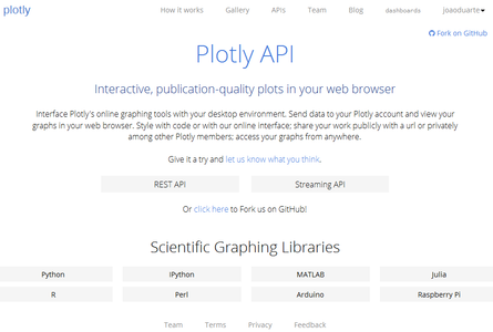

Now it's time to install the plotly API.
Go to the plotly MATLAB API page and download the zip archive.
Then unzip it and save it on the location you want.

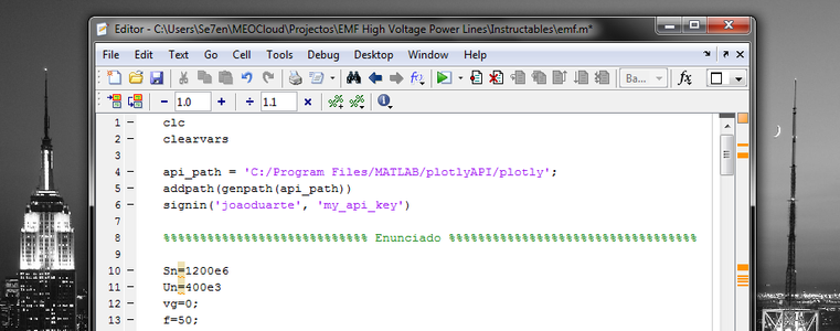

So the first thing you need to do is to add the directory where you saved the API data files to the MATLAB directory.
You can do this by adding these lines to your code:
>>> api_path = 'C:/Program Files/MATLAB/plotlyAPI/plotly';
>>> addpath(genpath(api_path))
Don't forget to change the directory above, in case you used a different location than me.
Authentication:
Now you must sign into your plotly account through your code. This is done using this line:
>>> signin('joaoduarte', 'my_api_key')
You must change the strings accordingly to your settings. The first string is your plotly username, in my case is 'joaoduarte' and the second string is your API Key, that you generated in the previous step, in your plotly profile settings.
Personally I like to put these lines with settings on the beginning of my code, since they are part of the general configurations, but you can use them anywhere you want, as long as they come before you start calling the plotly functions.

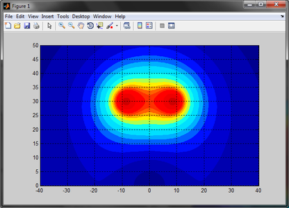

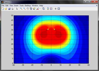

When you're sending data from the MATLAB API, you're basically sending JSON objects to the plotly website. These objects follow a very specific and organized structure, divided in parts, like data and layout.
The data part is basically an array with all the data trace info, like X, Y and Z points for example, as well as the settings for the graph itself, like the graph type and style.

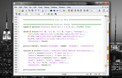

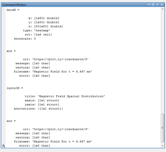

To send data info from MATLAB to plotly we can use an API function called plotly(). In my case, I want to send the x data, where X is an array, basically with the length of the X axis (40 m for each side, being 0 in the center), the y data, where Y is also an array but with the height of the area (from the ground to 50 m high) and the z data, which in my case can be either the matrix 'K' or 'C' (for electric and magnetic values, respectively). Besides, I will also send information about the graph type I want, in this case it's a 'heatmap' and the color scaling I like, which is defined in the 'scl' field. So these is what I need to write:
>>> dataM = struct('x', X, 'y', Y, 'z', C, 'type', 'heatmap',...
'scl',{{{0,'rgb(0,0,131)'},{0.125,'rgb(0,60,170)'},...
{0.375,'rgb(5,255,255)'},{0.625,'rgb(255,255,0)'},...
{0.875,'rgb(250,0,0)'},{1,'rgb(128,0,0)'}}},...
'showscale', false)
>>> plotly({dataM}, struct('filename', nameM, 'fileopt', 'overwrite'))

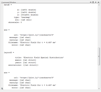

The plotly function also allows you to decide the name of the graph file you're creating on your plotly gallery, and if you're creating a new file or overwriting an existing one. These are done with the 'filename' and 'fileopt' fields. In my case, the variable 'nameM' is a string with the name I want the graph to have.
The function plotly() returns a response from plotly website that should look something like this:
url: 'https://plot.ly/~joaoduarte/8'
message: [1x0 char]
warning: [1x0 char]
filename: 'Electric Field for t = 6.667 ms'
error: [1x0 char]
After you received this response, your graph is ready on your plotly gallery!

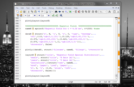

Now the layout part is basically an object with additional global chart layout settings, like the graph title, the axis labels, special annotations, among other things. To send layout info from the plotly MATLAB API, you can use the function plotlylayout().
In my case I will use this functionality to give the graph a title, to label the X and Y axis, and also to put the filename as an annotation beneath the graph. I will need to write these lines:
>>> layoutM = struct('title', 'Magnetic Field Spacial Distribution',...
'xaxis', struct('title', 'X Axis [m]'),...
'yaxis', struct('title', 'Y Axis [m]'),...
'annotations',{{struct('text', nameM,...
'xref', 'paper', 'yref', 'paper',...
'x', 0, 'y', -0.15, 'align', 'left',...
'showarrow', false)}})
>>> plotlylayout(layoutM)
The plotlylayout() function also returns a response like this:
message: [1x0 char]
warning: [1x0 char]
error: [1x0 char]
Like before, this means your new graph is ready in your gallery!

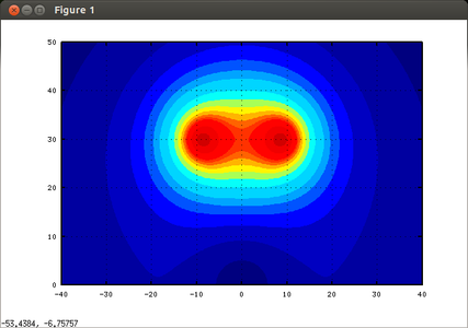

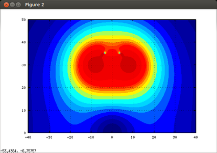

Step 5: Sending Data With Octave
Adapting the API:

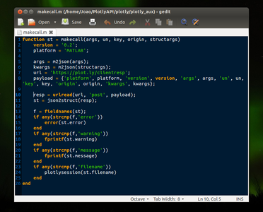

The steps for using the plotly API on Octave are pretty much the same as in MATLAB, however there is a small thing you need to do first, which is to change the API file, named 'makecall.m'.
You can find this file on the zip archive you downloaded, in the directory: /plotly/plotly_aux.
The only thing you need to do here is changing the word 'Post' to 'post' on line 10. Then you're ready to go!
From here on, it's all basically the same. For my case, I just had to change a few other things on the data and layout part, but I'll explain on those sections.
On this step, I'll focus more on the alterations I've done. Check the "Sending Data with MATLAB" step, for detailed info about each function.
Directories:
Here is exactly the same as MATLAB, changing only the directory:
>>> api_path = '/home/Joao/PlotlyAPI/plotly';
Authentication:
The sign in process is also the same:
Data:
So here is where I started having troubles. The data from my 'scl' field was formed by a cell of arrays with numbers and strings. The numbers had decimal points, that for some reason, were not being sent. Octave calculated them properly, but they were not being sent correctly.
I thought it might be because of the Ubuntu system language and regional format being in Portuguese, but I changed it to English, and nothing happened. I eventually fixed it by turning those numbers into strings, however, there might be a better solution.
I had the same problem with my X and Y arrays, when their increments were inferior to one, also because of the decimal point. What I've done here was to create new vectors, with the same size, but with an increment of one, changing their limits.
This works, but the axis limits on plotly will come out wrong. So I needed to fix them, by sending my customized scale within the plotly() function.
So here is the resulting code:
>>> XX=-400:1:400; %before was from -40 to 40 with increments of 0.1
>>> YY=0:1:500; %before was from 0 to 50 with increments of 0.1
>>> dataE = struct('x', XX, 'y', YY, 'z', K, 'type', 'heatmap',...
'scl',{{{'0','rgb(0,0,131)'},{'0.125','rgb(0,60,170)'},...
{'0.375','rgb(5,255,255)'},{'0.625','rgb(255,255,0)'},...
{'0.875','rgb(250,0,0)'},{'1','rgb(128,0,0)'}}},...
'showscale', false,...
'xtype', 'scaled', 'x0', '-40', 'dx', '0.1',...
'ytype', 'scaled', 'y0', '0', 'dy', '0.1')
>>> plotly({dataE}, struct('filename', nameE, 'fileopt', 'overwrite'))
As you can see, inside the 'scl' field, the numbers are now between single quotation marks, turning them into strings. The XX and YY variables, are my new arrays, with an increment of one.
The new functionalities used here are the 'xtype' and 'ytype' field names. This allow you to use the scale you want on the X and Y axis of your graph. The 'x0' and 'y0' are the first values, and the 'dx' and 'dy' are the increments. For example, on the Y axis, I want it to be from 0 to 50, with increments of 0.1, but I'm sending data from 0 to 500 with increments of 1, so I'll use these options to change it. I'll put 'y0'=0 and 'dy'=0.1, this will output the Y axis from 0 to 50.
So this problem came as a good thing, because it made me learn more functionalities about the plotly API.
Finally, this should output a response like the one observed on the previous step.

Authentication:

Step 6: Final Results
Finally is time for the results!
In the images above you can check the graphs obtained in plotly, MATLAB and also in Octave. As you can see, they are pretty much similar.
