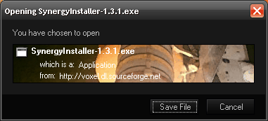

A window will then pop up, click Save File.

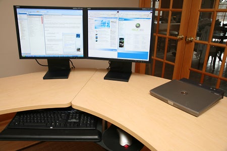

Setting up the client is really simple and must be set up on a computer next to the server machines monitor like in the picture.

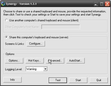

To set up the Server You first need to move to the machine next to the client and install synergy on it, and then open synergy like you did with the client and in the window click on the button next to "share this computer's keyboard and mouse (server)". That means that this computer is now the server, or the computer controlling the other computers.
now that the machine is the server you have to open the screen and links window . when the window opens up you need to click on the + button in the upper left hand part of the window, and add your screen name (The name you put as he servers name on the client machine) and the clients screen name. Now exit out of the screens and links window.

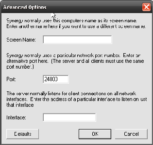

Now that the server has registered the names of the client and server we need to change the port number,so click on the advanced button and a new window will pop up called advanced options, type your screen name in again in the text area next to "screen name:" and also change the port number to the clients port number.
