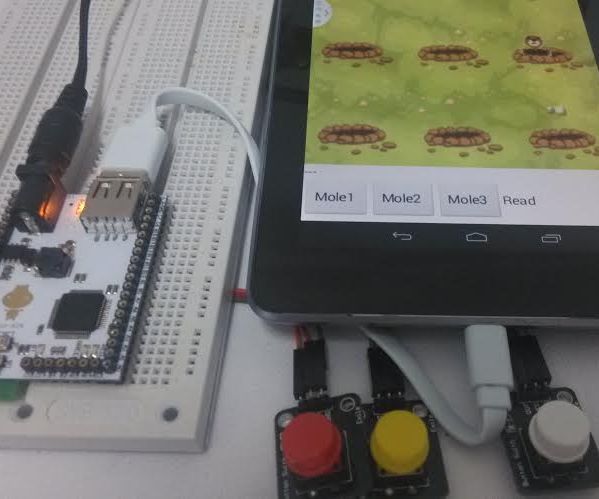

By using the HippoADK board and HippoADK-Lego Shield, Nexus 7 can read the status of the Lego Motors and can also control the Lego Motors. While balancing, with the gyroscope sensor in Nexus 7, the robot can adjust the status of the Lego Motors to keep balance. Hippo-ADK is an open-source electronics prototyping platform based on Android. By combining an Arduino-like microcontroller board with Android, not only does it allows you to tap into the powerful resources of your smart devices, but also to do so in an amazingly simple and elegant manner.
For more about HippoADK, you can see more details here.
