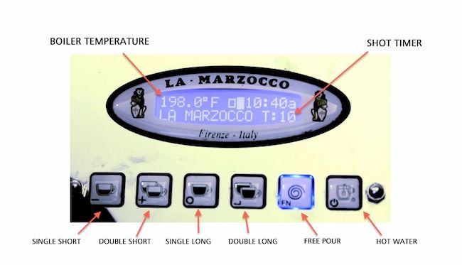

- shot buttons
These buttons send water through the machine into the portafilter. They are programmable to cater to individual tastes. The icons typically go like this : single shot, single long, double shot, double long. There is also usually a 'free pour' button, and sometimes a hot water button for the hot water spigot.

Place the portafilter in the grinder, and press the button.
Because you never know if someone set the buttons properly, I always press the 'free pour' button. This will just run water through your coffee until you press the button a second time to stop.
A single shot should take anywhere from 15-20 seconds, a double from 20-25, a triple from 25-30.
Our machine has a handy timer that counts the seconds that have passes since you began your shot.
