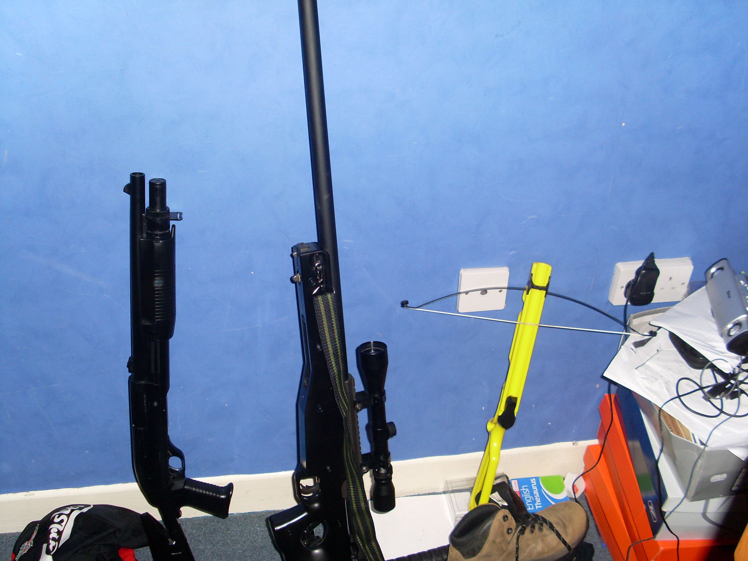

In this instructable I will be showing you how to adapt the chronographing method to give approximate rate of fire of an automatic airsoft gun.
You will need:
1. An airsoft gun
2. A computer with audio capture card ( one with a microphone input to be precise)*
3. A microphone
4. An audio capture program ( Audacity is open source, free and worked well for this application. It can be downloaded here http://audacity.sourceforge.net/)
5. A target that will cause a sound when struck and an appropriate backstop
6. As always with projectiles, A SAFE AREA TO TEST THE DEVICE AND AN APPROPRIATE BACKSTOP. ACCIDENTS HAPPEN AND SO PRECAUTIONS SHOULD ALWAYS BE TAKEN TO PREVENT INJURY.
