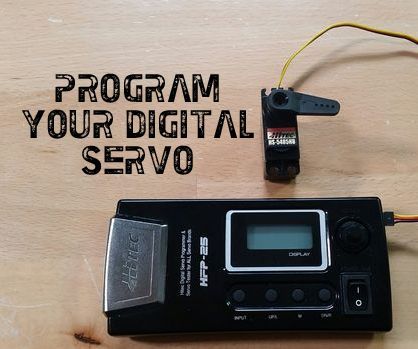

Brief version: right out of the box, the controller will run most servos about 90 degrees. You can overdrive most analog servos to 180 degrees by going through the range adjustment sequence below. Not many digital servos will be able to rotate 180 degrees using the range adjustment; 120 degrees is probably more realistic. To achieve 180 degrees out of a Hitec digital servo you could use a servo programmer to reset the endpoints within the servo's internal programming and then plug the reprogrammed servo into the Actobotics Servo Controller.
While it is less common to have a project where you want to reduce the rotation of the servo, you can also use the range adjustment feature to limit the rotation.
For the techy crowd: the default PWM range of the Actobotics Servo Controller is 989 - 2013usec. The range is adjustable all the way out to 477 - 2527usec. Analog servos can typically respond to a signal range from 600 - 2400usec which usually allows for 180 degrees of rotation (exceptions do apply). Hitec digitals can run on a signal range of approximately 850 - 2150usec which yields somewhere around 120 degrees of total rotation but the servos have no response to signals that fall outside that range. To get more rotation from a digital you must reprogram how the servo responds to the signal rather than just changing the signal sent to it. Most Hitec digitals can have the endpoints reprogrammed with a Hitec servo programmer so that when a signal range of 1000-2000usec is received it'll be able to do approximately 180 degrees. On most Hitec digitals, if the endpoints within the internal programming of the servo are set to their maximums (using a Hitec Servo Programmer), the servo will rotate approximately 180 degrees given a range of 1000-2000usec sent from the servo controller.
