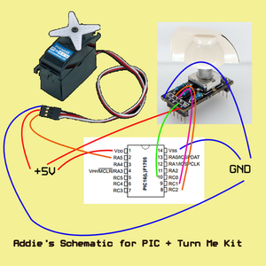

Step 2: To Use It With a PIC 16f1705
We also made it work with a PIC so that if you wanted to hook it up to a servo and have the quadrature encoder control which direction the servo went, you could!
