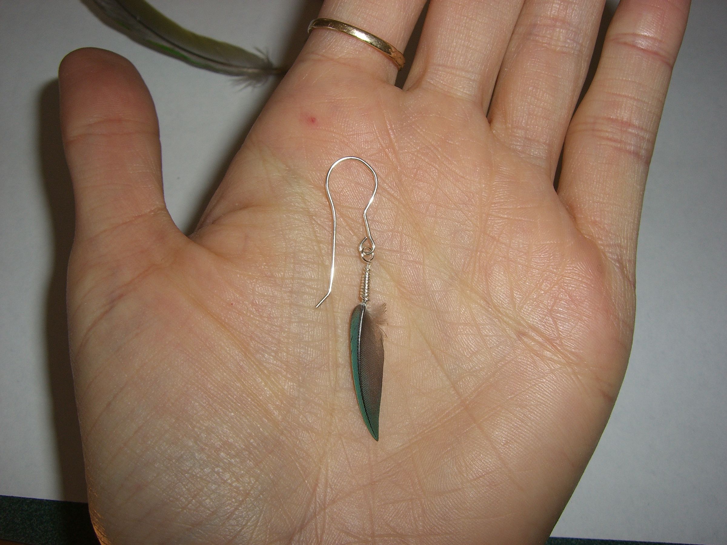

Gently straighten out the wire and use the round-nose pliers to create a loop at the end of the feather shaft.
Step 4: Finish Wrapping the Wire
Hold the feather firmly with your flat-nose pliers (you can grasp the loop you just formed, actually), and wrap the remaining wire back down the shaft. This will secure the loop to the feather, and cover up the shaft that you left bare in a previous step.
Cut off any excess wire, or wrap it all around the feather.
The feather is ready to be added to jewelry or decorations or whatever.
