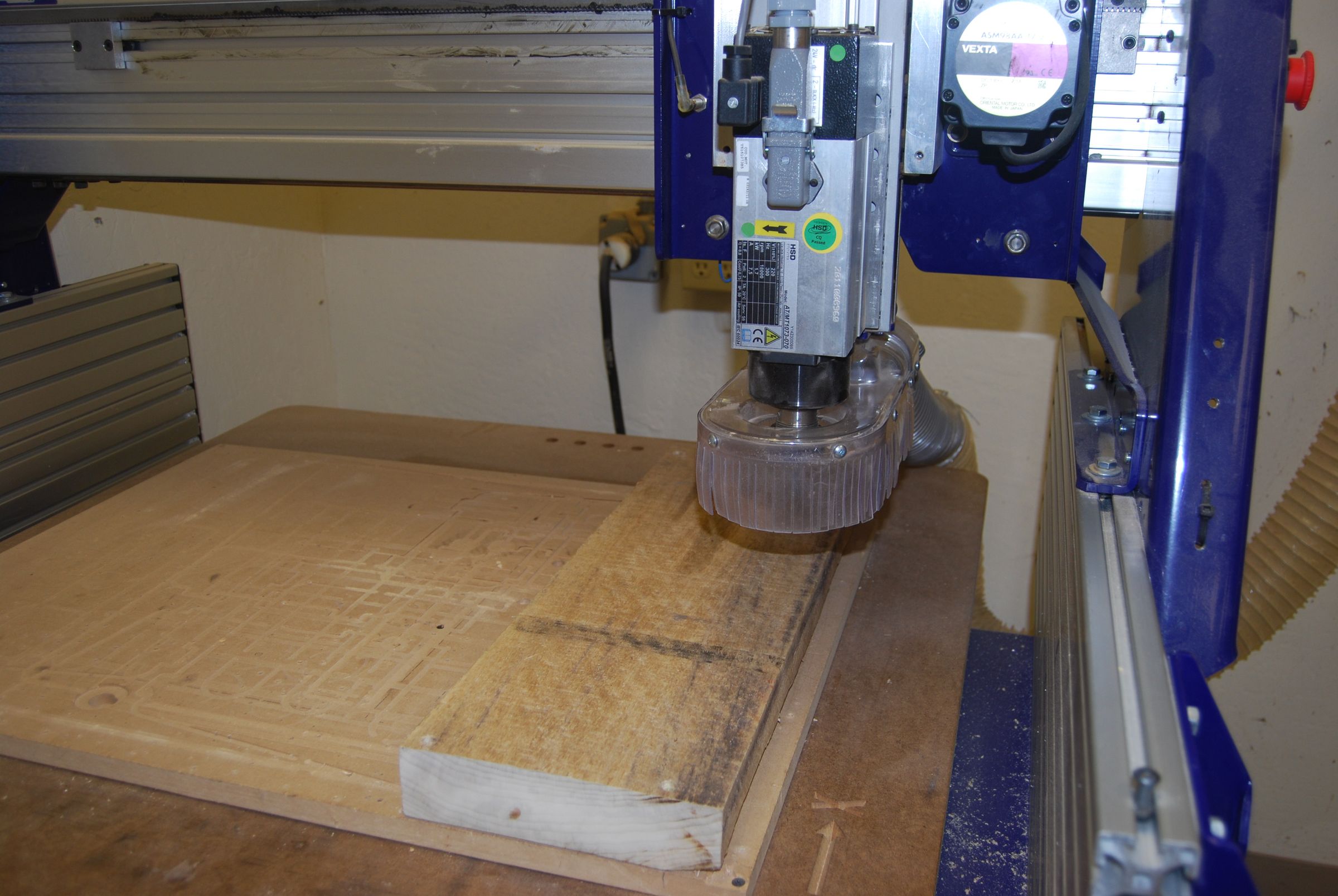

Now you will need to right click on the yellow box. In that menu it allows you to move the router head up and down and backwards and  forwards, left and right. Using the arrows position the router head on the table in a place where you can get an accurate reading using the Z plate

Now you go to the cuts menu and right click on C2 zero the z plate. Then slide the z plate out and place it the table click ok when ready to zero. The cutter will touch the z plate twice then you can put the z plate back. You can also z plate to the top of your material it all depends on your file.
