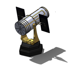

Introduction: Hubble Telescope With Polar Mount and ESPCAM
This project is a camera telescope inspired by the Hubble telescope, it has a polar mount controlled with 2 servos to modify its direction and can be charged with solar panels or USB charger.

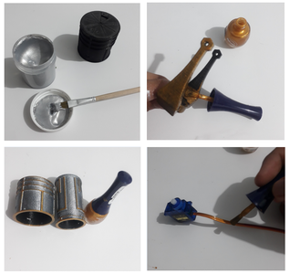

Step 2: Painting
Paint the two pieces of the telescope body silver, you can use vinyl or spray paint, with gold nail polish paint the mount and carefully paint the details of the telescope body, also paint the servo cable that will go on the base.

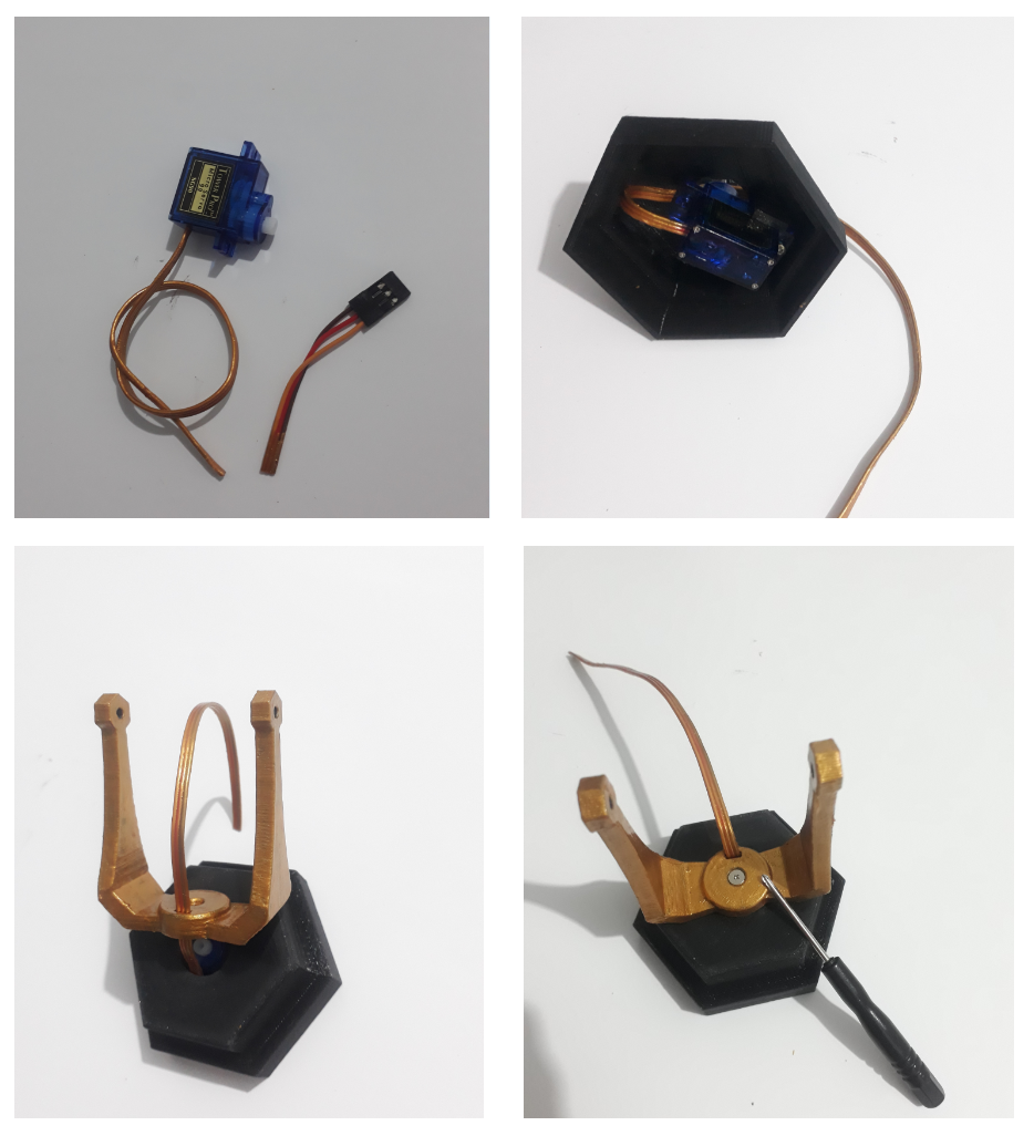

Step 3: Base
Screw the servo motor to the base and cut the cable, pass it as shown in the figure through the base and the mount, and then screw the mount to the servo. The cable has enough space to move freely between -90° to 90°.
Is important to set the two servomotors angles to 90° before screw them.

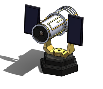

Step 11: Final View
Finally you will have a telescope-camera to monitor the place you prefer, do not forget that the more sunlight it receives the more autonomy the battery will have.
