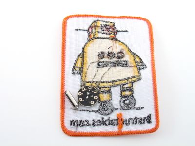

Step 1: Preparation
Arrange your pieces to see how they'll fit. I tend to put the electronics underneath my designs.
The sequins fit this patch so well. Nothing else comes in such tiny ready-to-sew form.
The thin conductive thread is perfect for this project. It has enough resistance so you don't need extra resistors for the sequins. Just remember to double-stitch.

Step 2: Lights
First, connect the "L" hole to the brass bead of the sequin of your choice. We'll sew all the minus (silver beads) in one go later on. Use long stitches underneath, and short stitches on top to make it neater. I think I could have done a better job, but I need another patch to sew on :-)
Step 3: Lights (2)
Sew down second sequin to the "M" hole of the learning sensor. Make sure to sew the stitches far enough so they don't touch.
Step 4: Lights (3)
Connect the third sequin to the "H" hole.
Because conductive thread tends to fray at the knots, experiment with starting your stitches a little distance from the holes on the learning sensor. Then work your way back to the hole, stitch well, and then move forward to the sequin. This way any unravelling won't cause shorts and touch other holes.

Step 5: Tilt Switch
Connect the brass bead of the tilt switch to the "C" hole of the learning sensor. Make sure the brass bead will normally face up when your project is finished.

Step 6: Battery Minus
First, make two knots in your thread, arout where the arrows are.
This enables you to have a decent coil that will be taped to the battery later.
Stitch this thread, connecting the brass beads of the tilt switch, the "_" hole of the learning sensor, and to the brass beads of all three sequins.

Step 7: Touch Sensors
Time to connect make the touch sensor using the robot's wheels. Start from the "S" hole of the learning sensor. Make large stitches on the top side of the wheels. These will act like antennas to detect touch and/or proximity.
Step 8: Battery Plus
Using the same technique for the minus thread, stitch some thread to the "+" hole of the learning sensor, leaving some extra to form into a coil
Step 9: Sealing the Battery
We really need to make a soft, ultra-thin battery holder. Until then, adhesive tape is the next best thing. It holds the battery really well, yet is easy to take off.
First, apply some tape to the minus thread as shown. This will help prevent short circuits with the battery "+". Wind the thread into a small coil and tape to the battery minus.
Step 10: Sealing the Battery (2)
Turn the battery over and do the same with the plus thread.
