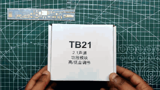

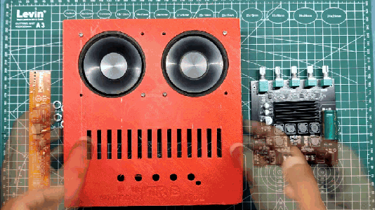

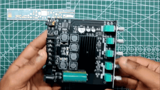

Step 1: Audio Module
For the audio control board, I'm using the ZK-TB21, which is a 2.1-channel audio power amplifier based around the TPA3116D2 power AMP chip.
TPA3116D2 is a Class D stereo amplifier that can drive speakers up to 100 watts; driving two 100-watt speakers, the ZK-TB21 utilizes two of these TPA3116D2 chips. one for the left and right speakers, and one for the subwoofer
Because it's a power amp, things get super hot, so there's a heatsink on the TPA chips for the dissipation of heat.
Also, there's a Bluetooth audio IC on this board, which lets us connect with this board for audio streaming.

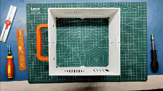

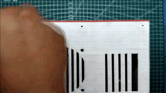

Step 5: 3D Printed Parts
As for the 3D-printed parts required in this build, I have reused the middle base part from a previous project.
I took the Cad file of the previous project and removed everything from it except for the middle part and handle with four holders that are keeping the middle body in its shape.
This middle body is divided into two halves, and four holders are used to mount both halves together.
I modeled the front and back portions for the middle base and added left-right speakers to the front and a subwoofer to the backside.
After completing the design, I exported the 3MF files and printed them on my Ender 3 with red PLA and a 0.4mm nozzle.

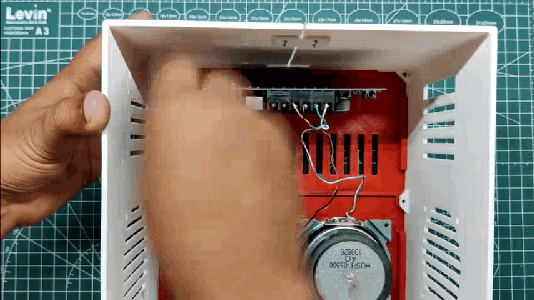

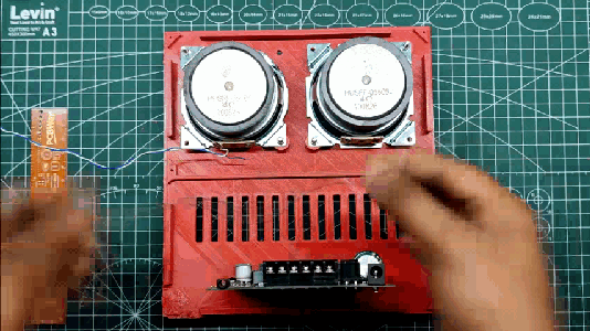

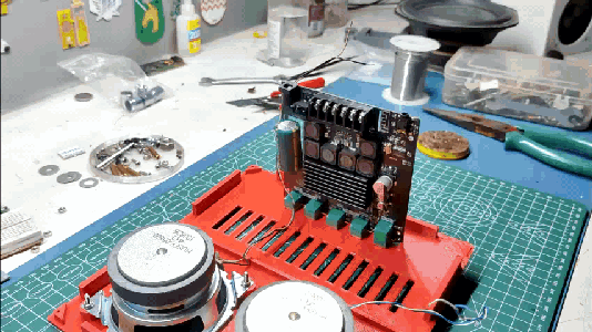

Step 6: Front Assembly-Left & Right Speakers
  • We first start the assembly of the Front part, we add Both Left and right speakers in their place by using two M3 Mounting nuts and bolts.
  • Next, we add Audio Module to its place by putting the pots in the holes on the body and tightening their locking nut to hold the board in its place.
  • after adding the audio module, we add wires to the positive and negative of both speakers by using a soldering iron.
  • Next, we add wires to the audio module in the right order by following the wiring diagram.

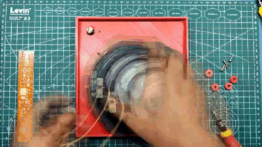

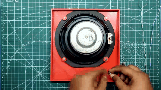

Step 7: Back Assembly- Subwoofer
  • Next, we start with the back panel assembly which holds the subwoofer in its place.
  • We use four M3 Nuts and bolts to hold the subwoofer.
  • Next, we place the DC Barrel jack and add Diode, leds, and wire to it which we can later attach to the Main Amp board.
  • We all add wires to the subwoofer's negative and positive terminals.

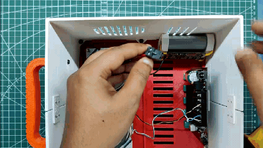

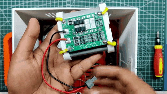

Step 9: Adding Battery Pack
Next, we add a 12V 5.2Ah Battery Pack inside the speaker body by first adding the ZK-TB21 Battery Connector (which was in the box) to the positive and negative of the Battery Pack. We can now plug the battery into the audio amplifier board.

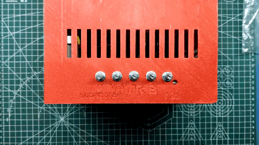

Step 11: Finishing Touches
To make this setup look pretty, we add potentiometer knobs to all five pots.
