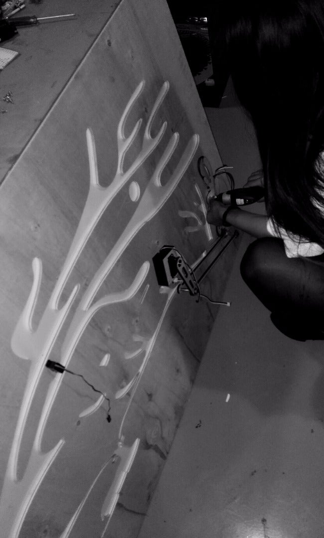

Step 6: Transform the Firelight Into the Fireplace
  1. Disassemble the Firelight that was bought online.
  2. Cut the board with a chainsaw and get rid of the parts that are not needed.
  3. Welding with Relay.

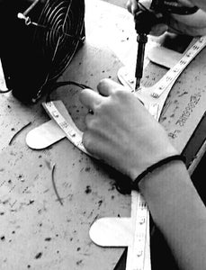

Step 9: The Deer God
  • Paste the LED lights on the board with the shape of Deer.
  • Welding.
  • Fix the board on the wood with several screws.

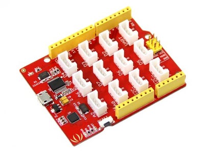

Step 10: Hardware Connecion
There are 4 Led strips and 3 Servos, as well as a Grove - Relay, Grove - Button.
And we have a Grove - Lotus, which has more that 12 Grove connector on board.
The connection as below:
  • LED1 > A2
  • LED2 > A0
  • LED3 > D3
  • LED4 > D2
  • Relay > D4
  • Servo1 > D6
  • Servo2 > D8
  • Servo3 > D5

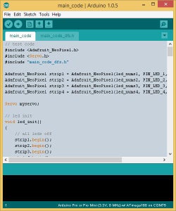

Step 11: Software Works
You can get the code from Github Page.
  1. When you get to the github page, find a Download ZIP button, click to download the code.
  2. The code you downloaded is not an Arduino library, it's a sketchbook, which is include all the library the project need.

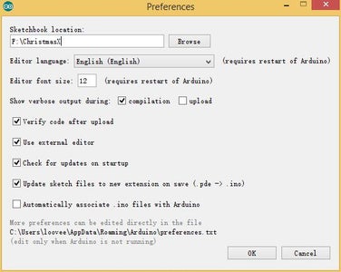

  3. Unzip the file you had downloaded from github, you will get a folder named ChristmasX-master.
  4. Open your Arduino IDE, click File > Preferences > Sketchbook Location, browse to the folder we had mentioned above - ChristmasX-master. Then click OK to save it.

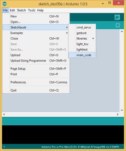

  5. Close and re-open Arduino IDE, click File > Sketchbook > main_code, then the main code of this is open.
  6. Choose the right board(UNO) and port to upload the code. Refer to the image above.
