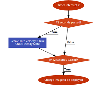

Step 6: The Code
For the code, we could have used the Arduino environment together with some libraries. This requires quite some overhead, and thus space on the microcontroller. Since we want to display images which can take quite some room, we wanted to avoid this overhead and go as barebones as possible. Therefore, we wrote our own libraries and used pure C code in Atmel Studio.
To make things clear, a flow diagram of the code is added. While in theory most of the concepts are relatively easy, in practice it's sometimes quite different. Sensors are not perfect: they are susceptible to noise, vibrations,... and take a finite time to measure. Execution time of code is also finite, while everything has to go as smooth as possible in real time. These are some of the things which we have to take into account while writing the code.
After initialising all the sensors, communication protocols and timers, we first wait until our motor has reached a steady state velocity. This is simply done by measuring each T2 seconds a velocity and comparing it with a previous measurement. Now that the velocity is relatively stable, we can synchronise the refresh rate of the LED strip to this velocity. Because a clear measurement of the velocity (degrees/s) is therefore needed, a running average over a few measurements is taken to suppress the noise influence. Now we can easily calculate the time T1 (s) that the LED strip needs to travel a certain angle (degrees).
From now on, every T1 seconds, an interrupt will be carried out that will send new data corresponding with this change in angle to the LED strip. Note that for more precision, the value of T1 is recalculated every T2 seconds. The last task remaining is to make sure the orientation of the image to be displayed is correct. This is done by constantly measuring the magnetic field strength and comparing it with a threshold that will only be exceeded when the strip passes the magnet. When this happens, we know we have rotated 360 degrees and can start redrawing the image. This threshold is an important parameter which can trade of certain performances. When too low, it will detect the magnet often too much which results in a constant (slight) shaking of the image. When too high, it will miss the magnet sometimes and the image will slightly drift away and then abruptly correct for this.
In the next sections we will explain all the important aspects of the code in more detail, but here's an overview:
