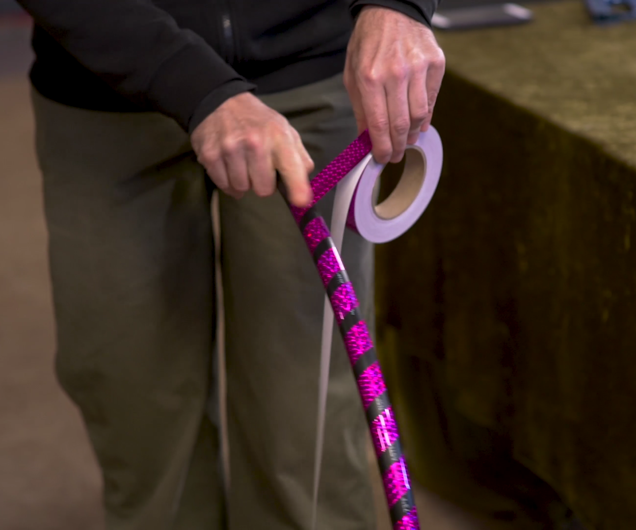

This hoop may be a bit slippery when using it as there is no "grip" on it. One of the ways a hoop becomes easier to use is by putting some grippy gaffer tape on it. Gaffer tape is a cloth tape used by all sorts of industries to make things grippy. If you watch our How to Tape a Hoop video, you'll see gaffer tape being used there.
