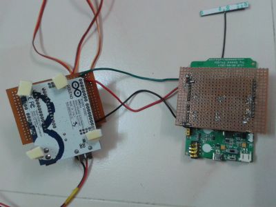

Step 2: Own Servo Shield
1) Make a servo motor shield for Arduino.(Be caredull if u even use 3v servos Linkit one have only 2 PWM pins)
2) I make a shield like PCB for Servo motor.
3) Using this board we able to control 6 Servo motors from arduino pind (3,5,6,9,10,11).
4) 3 Wire servos are used here. where power supply is given from external 5 V regulator power supply board.
5) While control servo use adaptor supply for Arduino board. Because PC USB power supply cause vibration. This cause over heat in Servo motor and damage the Servo motor. (one of my servo damage)
Step 3: Make Linkit One Connection
1) Linkit one want to talk with arduino to control the servos.
2) For that connect the Tx of the Linkit one board to the Rx of the Arduino board ad both Gnd.
3) when ever the data received it is send to the Arduino.
Note:-
If u have Arduino bluetooth shield then u control the whole setup using one board.

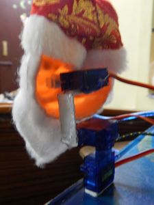

Step 5: Plan
1) Head rotate in 3 axis x,y,z.
2) The rotations are
a) Yaw - See left and right.
b) Pitch -See up and down
c) Roll-Shake side wise.
3) First use a Double side tape to plan the Servos.
4) Cut the Aluminum partition piece to L shape to fix the top servo to the second one.
5) Connect the the servo motor horn as per ur plan or as shown in the picture
6) All the servos center must be straight when in 90 degree.
7) stick all the servos and aluminum L piece using Double side tape and check the movement cant disturb other servos.
Step 6: Construction
1) Now its time to fix it permanently.
2) Remove the Double side Sticker one by one and fix it permanently using Hot glue gun.
3) Be carfully dont damage the servos.
4) Again connect the servo connector to the arduino board and switch on the supply
5) conform all strand straight like last image.

1) connect Both shield boards to the top of both microcontrollers.
2) Paste it all with Double side sticker one over another.
3) Be carefull don't shot any terminal.

Step 11: Fix a Face
1) Its x-mas time so found lot of santa claus dolls in shop.
2) Buy one doll and fix the head using double side tap to the top servo arm.
