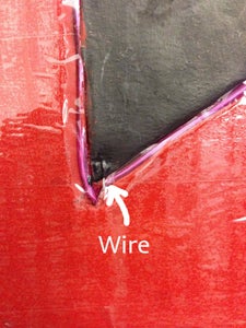

Step 6: Wire Up the Buttons
Now that the box is painted, it's time to wire it up. When wiring up the buttons, we ran a wire through the El wire holes and bent the tip of it so that it pierced the conductive paint. We then painted over it with a good blob of more conductive paint to glue it down. Tape it secure on the inside of the box so that it doesn't move around and disconnect from the front of the box.
For the pause button, we attached the two buttons with a short wire.
Be sure that the wires will all reach one corner of the box, where the breadboard will go.
