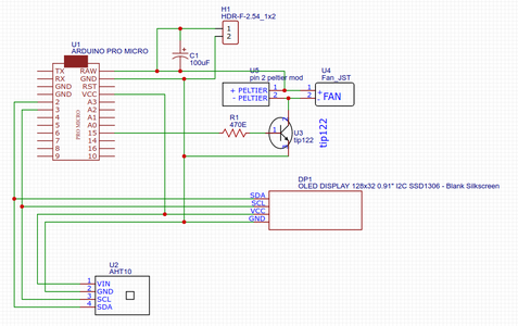

The AHT10 sensor can be used to measure the relative humidity and ambient temperature. An OLED screen can be used to display these values. And a simple logic of switching on the peltier whenever the relative humidity is above a threshold of 45%, is sufficient to get satisfactory results. Since the value doesn't vary wildly quickly, we can check this leisurely once a second. The peltier will draw around an amp at 5V. So the arduino will need a transistor / relay to control the current flowing through the peltier. A TIP122 darlington transistor, equipped with a small heatsink will do the job for us. The fan and peltier are controlled by the same TIP122. The schematic shows how all of this is wired up.
I used a visiting card box for housing the control electronics, with cutouts to let air move around, and for connectors to enter the box. The OLED display is placed outside the box for easier visibility.
A barrel jack connector on the outer box, will provide the power to the electronics. The barrel jack should be powered by an external 5V supply capable of providing at least 2A. We are not using the USB for the power because it is limited to 500mA on most Arduinos, and we need significantly more than that.
