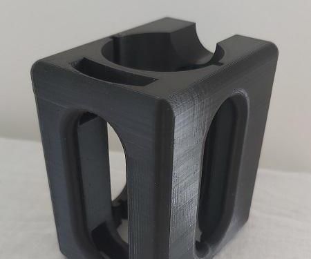

In order to use the the programmer you need to short out two pins when uploading the code (see attached photo). Once installed, ESPHome can use OTA uploads so the programmer is no longer needed.

Step 3: Final Product
The PCB I used is one I created for general ESP01 projects, hence there are some pins that are not connected to for this project.
