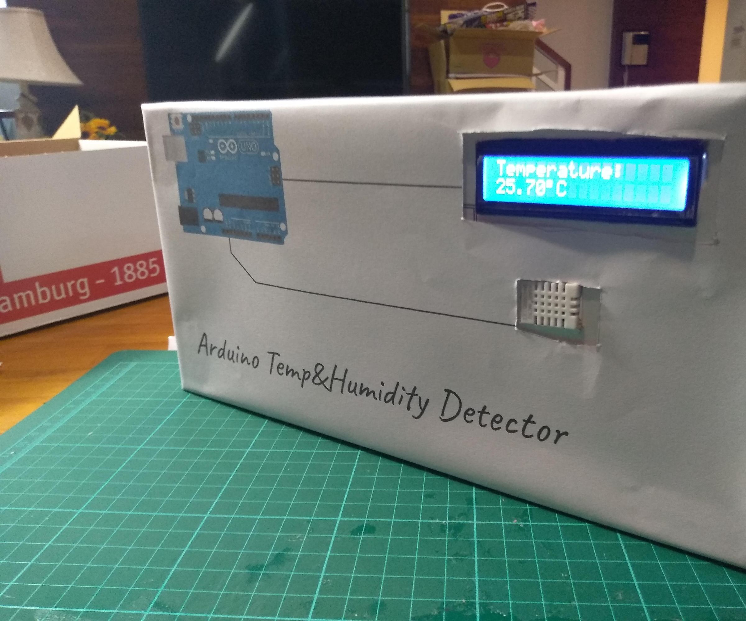

Step 3: Step 3: Decoration
After upload, the source code and your Arduino and components can work smoothly, you need to make a cover for your product.
You have to find a shoebox.
  1. You measure the width and length of your LCD panel and DHT 22 sensor(only the screen part on LCD and the white sensor part of the DHT 22 sensor)
  2. draw the measured area on the side of the box and cut it
  3. You can stick your components in the box and embed the LCD sensor and DHT sensor on the hole you create.
  4. You can also create a huge hole for the button(I just embed my button on the breadboard so I extend the wire on the breadboard so I can just press the button without creating a hole)
  5. You can start to decorate your box!!!
