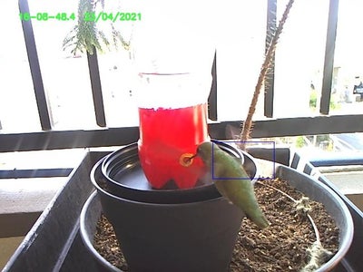

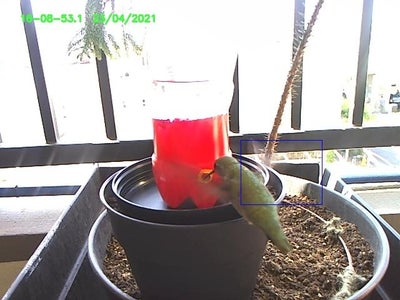

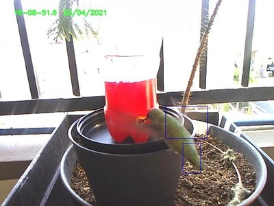

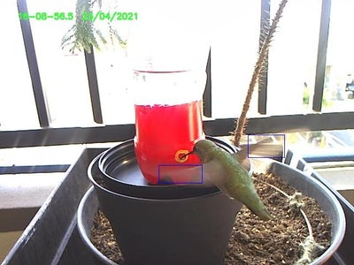

Current Version - Base
Take one 12-fluid ounce plastic bottle (the size of a small bottle of soda) and cut it with a knife about 3 inches from the bottom
Paint the outside of this base red (do not paint the inside). It can be painted with any convenient red paint (e.g., spray paint, brush paint, nail polish).
Put three (3) holes equally spaced around the bottle about 1 inch from the bottom. We made the holes using a metal-shish-kabob skewer. We heated the tip of skewer and stuck it through the bottle, but a knife or something else should also work.
- Note: We determined the height of the holes by taking the autofillling container described in the next step and inverting it into the base without holes. We marked the level to which the container filled the base and put the holes just above this fill line.
Paint a yellow circle (or flower petal shape) around each hole with the hole at the center. Almost any yellow paint should work (e.g., brush paint, paint pen, nail polish).
Step 2: Create the AutoFilling Container
Take one 12-fluid ounce plastic bottle (the size of a small bottle of soda). You also need the plastic top for the bottle. Create a hole in the top. We made the hole using a Power Drill with a 3/8 inch bit although there are other ways to create the hole (e.g., with a knife).
Fill the bottle with hummingbird food. Invert the bottle into the base and tilt slightly so that the food continually fills the base.
We keep this hummingbird feeder in a planter with a small evergreen tree. We put in on top of the lid from a container of protein powder. The lid stabilizes the feeder and gives the hummingbirds a place to sit. The hummingbirds now relieve themselves into the planter while eating - much tidier and ecofriendly.
We have had as many as three hummingbirds eating from the same feeder at the same time. No ants and no bees in the hummingbird food.
