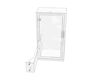

Step 1:
Everything has to start somewhere and a crude sketch is my first step.

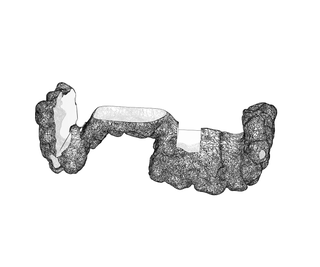

A wall was built using Sculpey clay, and Humpty fit inside. This wall was scanned (after being cut in three pieces) and the scanned pieces were combined in Tinkercad.
