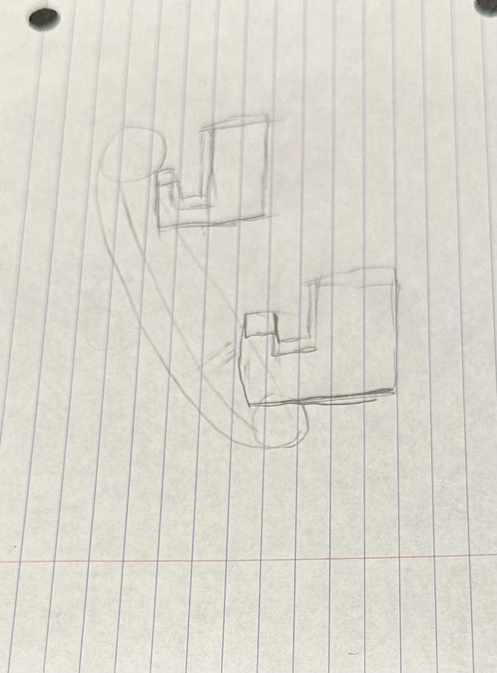

Step 3: Initial Drawing
This sketch depicts an early design for a wall-mounted archery bow hanger. The drawing features two L-shaped bracket arms, likely made to hold the limbs of a bow securely in a horizontal position. Each bracket is drawn with a vertical segment (for attaching to the wall) and a horizontal arm (for supporting the bow).
