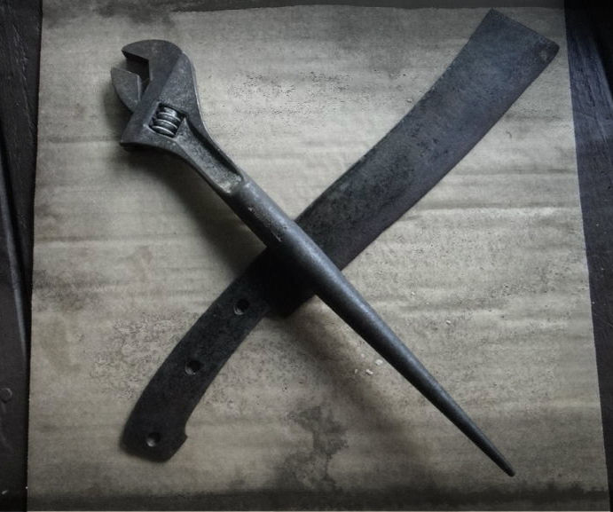

About knives, a folding knife won't work here. It needs to be about 8--9 inches or longer and not much more than an inch wide. Since so many knives are different I can't really say how it comes apart for each one, but I got a picture of how mine came apart. This is an easy kind to use for this application. Just a couple screws hold it together. Any 1/8 inch thin metal knife shank can work, but all I have to use is a nice gerber tactical knife and I want to have the option of it to still be a knife, down the line. So I tried to make it modular, or permanent and temporary at the same time.

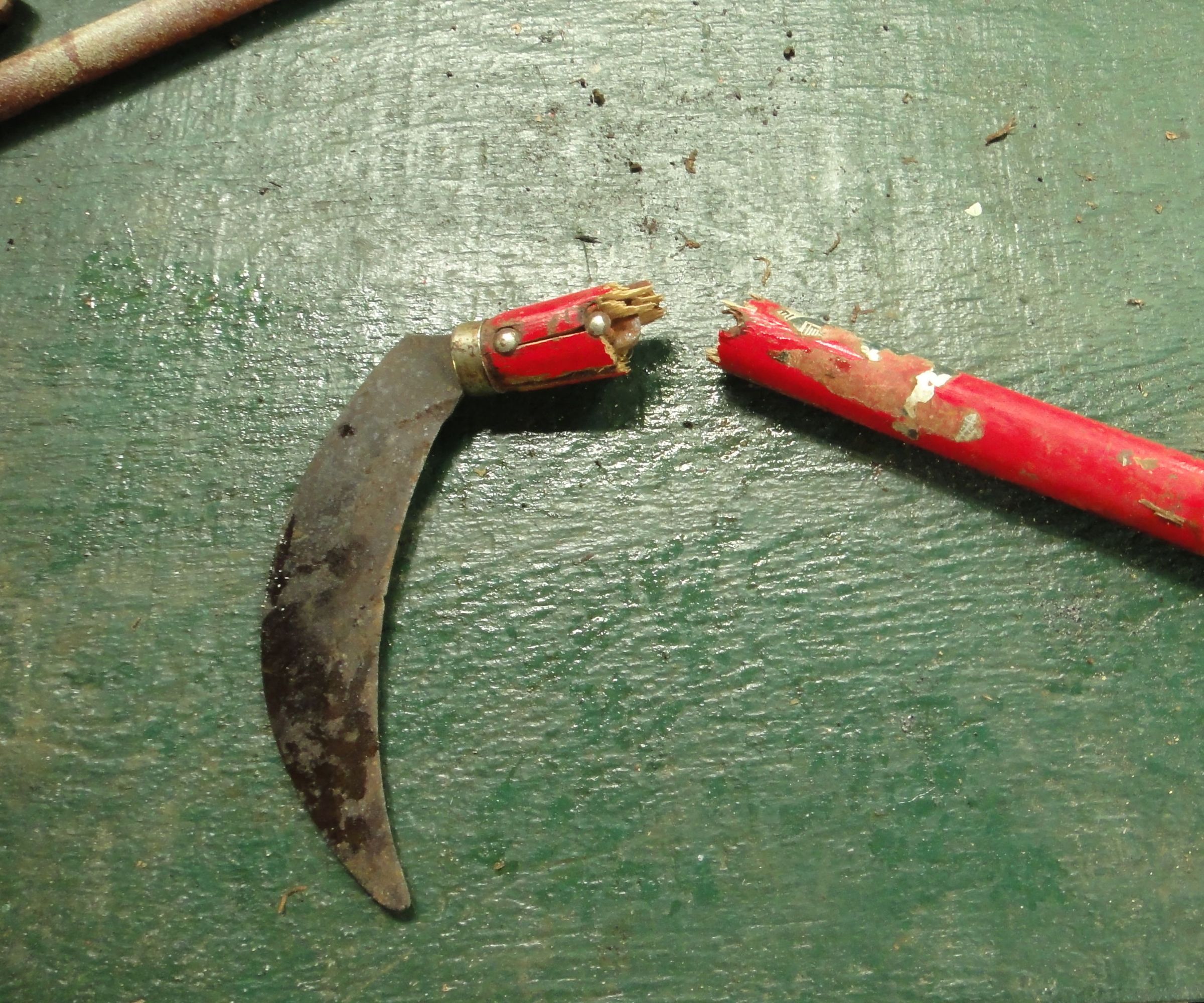

Using the chopsaw, cut the threaded end of the broomstick flush. Then turn the saw to 45 degrees and make an angled cut. Turn the broomstick and measure the cut to give an even "V" off the end. Place the knife next to the broomstick on a table. With a measuring tape and marker, find the best depth for knife tang. Keep in mind the holes for the nails (where the screws use to go through the tang) during measurement. Draw a line like in the picture. This line is the cut for the knife tang to fit. Tricky on a chop saw. I had to turn it over to finish the cut. I think a table saw is better here. After the cut, I stood up the broomstick in the vice and finished clearing up the slot with a sawzall until the tang fits nice and snug.
