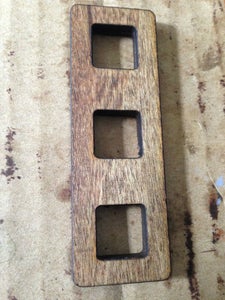

Step 5: Glue - Pieces
The piece with the 3 holes is a jig to align the sides and to position the nubs. This is not a puzzle piece! The last two pictures shows which pieces to glue on which piece. Glue the nubs on one side first, then let the glue dry. Repeat on the other side.
