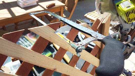

The lattice needs to be cut back to allow the lattice cap to fit onto the open side. I've tried a variety of approaches, and what worked best was my decrepit old hacksaw. A hand-held jigsaw just vibrates the lattice without cutting it. In any case, cut right at the point where the pieces cross as is shown in the photo. With a good blade on the hacksaw, the work went quickly. Do this for all four panels.
