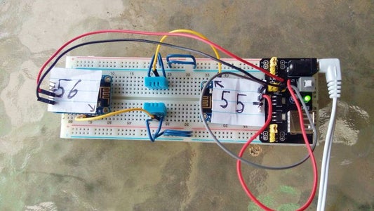

The picture is the current version, which will be drastically changing as soon as I get parts in. Right now it's labeled with 55 & 56 because those are the IP's I assigned to each. Using the IP numbers also helped to know what was reporting to Adafruit. You can see that I'm using DHT11's, which after my week long testing session with them, I do not recommend. They are both 5 degrees apart from each other at all times and neither is ever actually on target with what the actual temperature is.

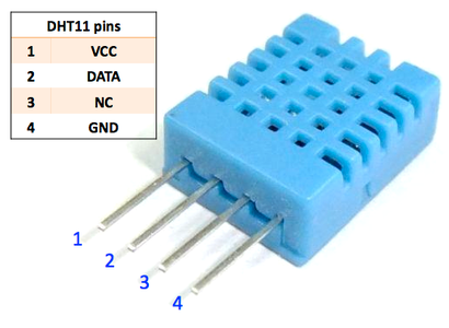

For the purposes of this instructable I'm just going to discuss the DHT11, however, the pinout diagram for the DHT22 is the same. If you have something else like an LM35, you may need to google how to hook it up (I believe that the LM35 uses an analog input to connect to, of which the Huzzah ESP8266 has only 1 of so plan accordingly).
A breadboard - regular or half size. I used two Huzzah's so I used my regular sized breadboard to hook it all up. You can probably get away with a half size if you're only using 1 Huzzah and 1 sensor, but the Huzzah also has to connect to the breadboard so it will probably get crowded quick.
If you plan on putting your weather station outside you'll need a separate power supply. I used a common breadboard power supply using the 5.5v outputs and a 9v wall wart to power it. While I was in the hook up/testing stage I started noticing that the usb power wasn't enough for all four components I had going. Once I switched it to the breadboard power supply I noticed a turnaround with the data and things started making more sense, without any wifi drop outs too.

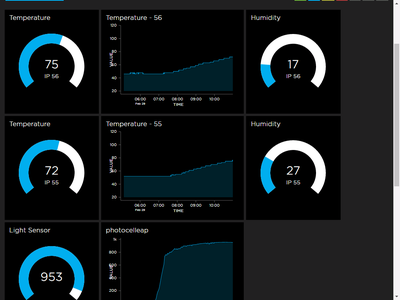

Adafruit IO account - Get one here. Also you can view my current weather dashboard.

From the Fritzing schematic, the DHT11 pinout diagram and the picture of my breadboard you should be able to wire it up easily. The Fritzing schematic didn't have the same type of breadboard power supply that I have, which basically supplies power to both sides of the breadboard simultaneously. You'll want to power the Huzzah and the DHT11 with 5.5v.

On my Dashboard I have gauge widgets for current temperature and humidity and line chart widgets that show a 5 hour temperature history. There is a blue + you click to add a widget. Just select the one you want, choose a feed to connect (which will conveniently already be there and working if you followed the last paragraph), set the parameters and you're all set.

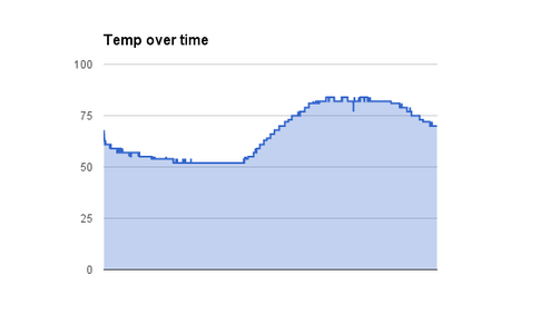

So far I've had my current set up outside for a week and I haven't had any dropouts. I'm getting data, but due to the low quality of the DHT11's it's not very accurate. As I stated in the begining both are off from reliable sources by a few degrees in each direction and both of the DHT11's are off from each other by 5-6 degrees all the time. I plan on posting future updates with other various temperature sensors that I'm planning on testing and posting new code and info on any other sensors I throw into the mix. Enjoy.
