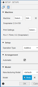

To print the part I used the Fusion 360 additive function in the manufacture workspace:
  • Select 'Setup' from the toolbar. A small dialog should open with different options to setup the process.
  • In 'Operation type' select 'Additive'.

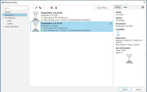

  • In 'Machine' click 'Select'. This will open the machine selection library. Some machines are already included in the Fusion 360 machine library including the Prusa Mini + which I used to print this part.
  • If your machine is not included in the library, select any other machine and use the copy and paste icons (on the top toolbar) to move it into your 'Local' folder in the file tree on the left side of the window.
  • Click the little pen icon to edit the machine settings including the dimensions of the printing envelope and temperature limits. You will also need to choose a post processor; for many machines e.g. Prusa, there are post processors to choose from the provided list. In the case of the Snapmaker, there is no specific post processor but I used 'generic fff machine' from the list and that worked fine.
  • Select the configured machine and click the select button in the bottom right corner.

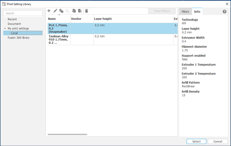

  • Now click select the print settings button. You will be shown a similar dialog box as before but with a library of materials. There are some premade profiles, but you will likely want to edit them for your own preferences. The slicer in Fusion is simpler than the common Slicer programs e.g. Prusa Slicer, Cura. But it doesn't have some of the more advanced features at the moment e.g. ironing.
  • Once you have selected a material profile, you can then select the model you want to print in the 'model' subsection.
  • You can also tick the 'Automatic' checkbox in the arrangement subsection to automatically arrange the parts on the print bed.
  • Click 'Ok' to close the Setup dialog box.
  • Right click the setup in the tree on the right hand side and click 'Generate' (or Ctrl + G) to generate the additive process.
  • If you are happy with the setup. Click on the 'Post process' button.
  • This will open the post processing dialog. Select the post processor which is appropriate e.g. 'generic fff machine .cps' then click 'Post' and save the gcode file.

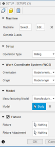

  • Select setup on the top toolbar.
  • This time select 'Milling' for the operation type.

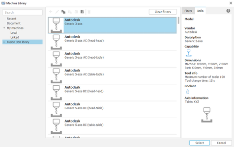

  • You will again need to select a machine from the machine library, but this time it is a 'Milling' machine (click the checkbox on the right hand side in the fusion library). As in my case the Snapmaker was not in the library so I had to configure a new machine.
  • Select 'Generic 3 axis' from the list (or however many axis your machine has) and copy it into your local library.
  • Click the small pen icon to configure the machine e.g. work envelope, maximum feed speeds, coolant etc. Once you are happy with the machine configuration, select it and click the 'select' button in the bottom right.
  • You will need to set the orientation and origin for the workpiece using the options provided. The origin location is important, and it is best to make it a location on the part which is easy to reference e.g. a square corner.
  • The model subsection is to select the body which represents the shape of the part after machining.
  • In the fixture subsection you can select the models of any fixtures on the design e.g. hold down clamps, screws. This way fusion can avoid colliding into them when generating the toolpath.
  • Click the 'Stock' tab on the setup dialog window (the yellow cube) and select the body which represents the object before machining i.e. the stock the part will be machined from. Ussually the stock is a square block of solid material, in this case the stock is the specific part I 3D printed, so select that.
  • Click 'Ok' for the setup.
