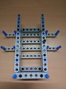

Step 2: Hardware
One of the more aesthetically important elements of this project is the chassis. After days of breaking my nails between Legos, I've finally made this chassis for the robot and controller using the Lego Mindstorms kit. The robot chassis has a battery bay, two motor harnesses integrated to the spine to offer more rigidity, a Raspberry Pi pseudo case, and finally, literally like a cherry on top, the motor driver circuit harness.
I've found this method of prototyping to be very effective over stuff like cardboard or wood.
