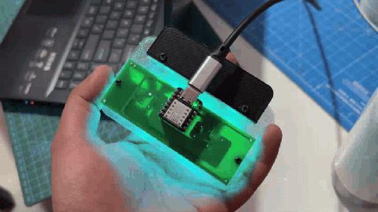

This is Hydrate Loop Bot, a smart reminder Desk Bot that makes sure users never forget to drink water throughout the day.

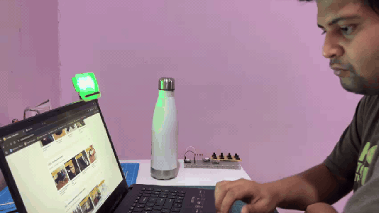

This Reminder Tool consists of an XIAO SAMD21 Microcontroller and a customized RGB LED board. The LED glows green for two hours; after that, it turns sky blue and begins to flash quickly, signaling to the user that it is time to drink water. The sky-blue led will blink for 60 seconds before turning green again. After two hours, it will revert back to sky-blue, and the process will repeat indefinitely.
We designed this Bot so that it can be placed on top of a laptop display screen and powered via the USB port. The reason for placing it on top of the laptop was simple: it is easily seen because it is in our field of vision.

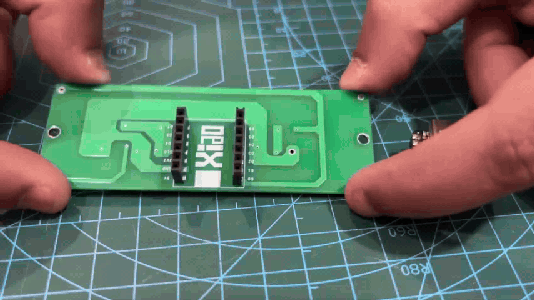

Step 3: RGB LED Board
We are repurposing one of our previously Created RGB LED circuits from an old project.
You can check out its article for a more thorough build guide for this circuit.
https://www.instructables.com/Wi-Fi-Status-Box/
The XIAO is connected to four WS2812B RGB LEDs via GPIO0. The WS2812B LEDs are all linked in parallel, with the first LED Din wired to GPIO0. The first LED Dout is connected to the Din of the second LED; the second LED Dout is connected to the Din of the third LED, and so on till the fourth LED.
Each LED has its own 100nf decoupling capacitor connected to VCC and GND.

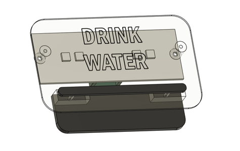

Step 4: 3D DESIGN

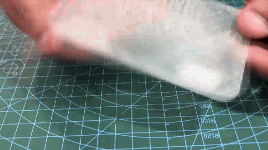

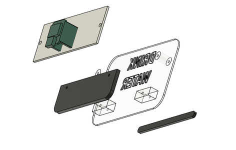

The 3D model for this project was quite straightforward; we began by creating the model for the XIAO and WS2812B LED circuit in Fusion 360 and then created a fixture and diffuser-like part that will allow us to secure the setup on top of a laptop. We accomplished this by first making a diffuser part and then connecting the RGB LED circuit to it; the RGB LED will face the diffuser's inner side. For visual emphasis, we also put the phrase Drink Water inside the Diffuser, which will be visible when the LED lights up.
For placing the device on top of the laptop, we created a second holder-like component that will be secured to the rear side of the diffuser with two M2 screws; this component will allow us to position the entire device on the laptop.

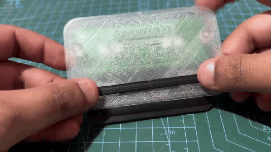

Additionally, to add a slight aesthetic accent to the diffuser, we printed a line-like part that will be superglued on the front face of the diffuser. Diffuser will be printed in transparent PLA and Back holder part along with Line will be printed in Black PLA; this color combo will prepare a two-color-looking device that will look aesthetically nice.

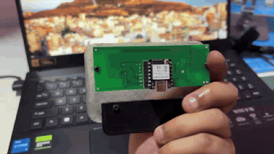

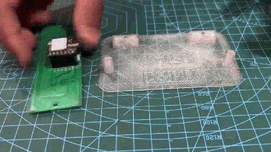

  1. Assembly priocess of this projects begins by pairing XIAO Dev board on the WS2812B RGB LED circuit.
  2. We take our circuit and place it over the mounting screw bosses given on the diffuser part using two M2 screws.
  3. Next we place the holder part in its place and use two M2 screws to secure it with the diffuser part.

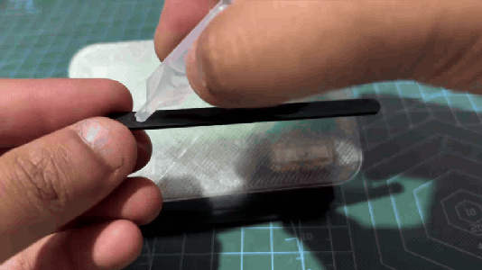

  4. At last, we use super glue to attach the Accent line part on the front side of the diffuser.
  5. We now place the device on our laptop monitor and power it using a USB Type-C cable connected between our laptop and the XIAO dev board.

Here's the end result of this simple yet helpful build: a Water Reminder Tool that fosters a healthy habit of staying hydrated, which is vital for overall well-being.
By providing periodic visual reminders with soothing and engaging light effects, it gently prompts users to drink water without being intrusive. This can be particularly beneficial for people with busy lifestyles who often forget to hydrate, as well as for individuals aiming to improve their hydration habits. The fading green light creates a calm environment during idle periods, while the blinking sky-blue LED acts as an effective visual cue, ensuring users don't overlook their hydration needs.
