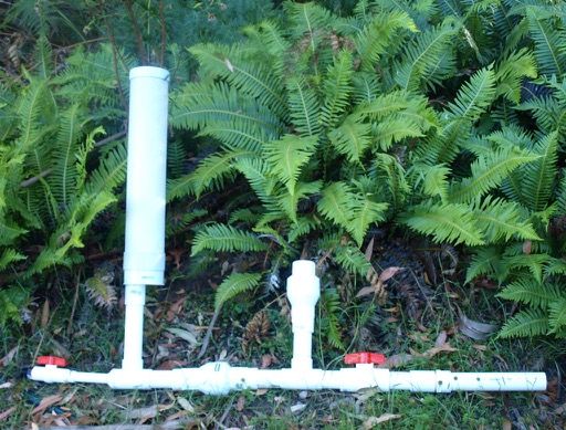

Step 5: Piece by Piece (Main Line)
I began at one end of the pump, with the 1-1/4" valve to the 1-1/4" union. You can choose to start with other pieces, but I found that setting up the main line gave me something easy to clamp up. After the 1-1/4" to 3/4" bushing is on this tee, you can glue up the end assembly separately, and then connect it to the main assembly with the threaded 3/4" pipe.
When connecting the threaded sections, make sure to wrap some teflon tape around the threads. This will help the operation along and prevent leaks at these joints.
Step 6: Piece by Piece (Pressure Chamber)
Now you need to put together the pressure chamber. Gather up your big pipe section, cap, adapter, bike tube, and bike pump. Using the pump, partially inflate the bike tube. Don't pump it up all the way, just enough that the tube is squishy. We need the air in the pressure chamber to act like a spring.
The bike tube prevents the pressure chamber from becoming waterlogged during operation. Air dissolves into water. It does so more readily at high pressure. (This is related to how commercially produced soft drinks are carbonated) The bike tube sequesters some of the air from ever contacting the water (in theory), and prevents all of the air from being carried out of the pressure chamber.
Stuff the bike tube down into the big pipe, a la image two. After this, cement on both ends, and clamp that sucker up. Once that's dried up, go ahead and glue this whole assembly to the pipe coming from the main tee.
Note on possible improvements / modifications:

So here goes for the operation of the pump.
As the pump cycle begins, water flows down the stand pipe, and up through the swing check valve. Water begins to flow faster and faster around the flapper in the check valve, until friction draws the flapper up, slamming it closed. This causes a pressure spike in the pump body, as the water flowing down the stand pipe at some speed no longer has anywhere to go. This pressure is relieved by some of the water flowing across the spring check valve, over onto the pressure chamber side of the pump. Once past the swing check valve, it cannot return, and has to stay there. When the pressure difference across the spring check valve drops, the valve will close and water will stop flowing through it. The lower pressure will allow the swing check valve to open again, beginning the cycle all over again.
Troubleshooting
So what if this doesn't happen? Well, first things first, check and make sure that it's "on". That is to say, make sure both the 1-1/4" and 3/4" valves are in fact open.
Sometimes water will flow out of the swing check valve, then the valve will slam closed, but nothing will happen. If this occurs, tap on the flapper in the check valve to open it up again, and let the cycle begin again. In theory these pumps need some back pressure (coming from the pressure tank side) to operate, but I've never had any trouble getting mine going with just some basic tapping and fiddling.
Tuning
Now that it's working, can you make it work better? You'll find that there's a maximum height that the pump can deliver water to. Be patient when trying to find this, as it takes a little while for the pump to achieve the pressure required to raise the water up higher and higher. There are formulas that will tell you how high you can theoretically pump water based on the source water head. Feel free to look them up.
Tuning ram pumps mostly involves varying the water velocity that results in the swing check valve closing. A higher water velocity will generate a larger pressure spike, allowing you to pump to greater heights. But it will also cause a slower cycle, so you pump more slowly. If the valve closes at a lower water velocity, it will take less time for the water to reach that velocity, so the pump will cycle faster, and the water pumped faster, but you will not be able to pump as high. So that's the trade off. Keep in mind though, that this will work without interference 24 hours a day, so combining it with a holding tank, you can get a decent supply of water built up.
To tune this specific design, you take advantage of how gravity acts on the flapper. When the check valve is pointing straight up in the air, the full force of gravity holds the flapper down, so the water must flow past the flapper faster to generate enough drag to raise the full weight of the flapper. By rotating the pump about the main line, you put the flapper's degree of freedom at an angle to the force of gravity, so that less drag is required to move the flapper. You could work out all of this fairly easily with a bit of trig, but I feel it would serve you little use out in the field. Just play around with it, you should find a position that works well for your application.

Ok.. we built the thing !! We have tried so mary ways of making this work but I guess we just aren’t getting the gist of how it works to make it work !! We have a creek .. we have the hose going into it.. but the flapper never flaps !! It just flows out the overflow!! We have poked the flapper many times and that don’t seem to help ?? So we are at our wits end and need help !! A written diagram for dummies would be helpful !! Lol ty for any help !!
Answer 2 years ago
Besides reversing the connections reread the bit about the drive pipe. It needs to be a solid pipe. Schedule 40 PVC is much better than thin wall.
Answer 3 years ago
Your pump is backwards. Switch the head pressure tank to over the 90 and the opend check valve over the T. Then the cycle will occur
Answer 3 years ago
My guess - You probably don't have enough back pressure. Either you need much faster moving water, or you need a larger diameter hose feeding the pump. If you take a look at this similar ram pump, it says it requires 8 gpm and a 1-1/4" prive pipe.
