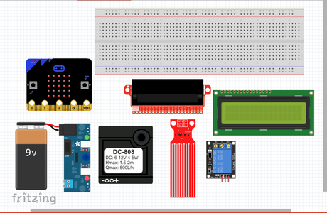

For this project you will need:
micro bit
Soil moisture sensor
jumper cables
relay
breadboard source
breadboard
lcd screen 1602 i2c
tomato seeds
Pass
mini water pump
9v battery
micro bit pin extension

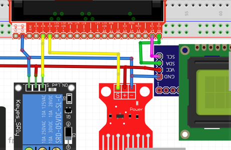

Step 1: Connections and Operation
Connection steps:
Connect the I2C module to the 1602 LCD:
Connect the SDA pins of the I2C module to the SDA pin (P20) of the Micro:bit.
Connect the SCL pins of the I2C module to the SCL pin (P20) of the Micro:bit.
Connect the VCC and GND pins of the I2C module to the appropriate supply voltage and ground (you should use 5V and GND)
Connet the Relay:
connect the relay to 5v and gnd from the source, we will take pin P1 of the micro bit as a trigger output signal to activate the pump.
Connet the Humity Sensor:
Connect the humidity sensor to 5V and GND of the source, we will use pin P2 of the microbit for the analog reading of the sensor.
Do not forget to connect the gnd of the supply to the gnd of the microbit, this will balance the voltages since the micro bit works at 3.3v

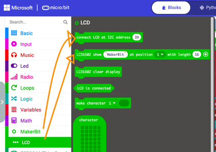

Step 4: Shows Text and Data on LCD Screen With the Extension
Download the extension by going to the extensions block and typing lcd
Step 5: Shows Text and Data on LCD Screen
go to the Makerbit - lcd block and place the blike connect when starting to establish a connection with the lcd, and then drag the lcd1602 SHOW block to observe text and data and place it in coordinates

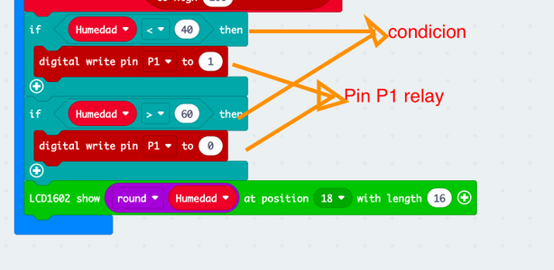

We will establish the pumping working conditions using logic, on this occasion if the humidity is less than 40 the P1 of the micro bit will be activated giving the order to the relay to turn on the pump.
then the humidity changes to greater than 60 to turn off.
then we round the value of the variable humidity to avoid decimals

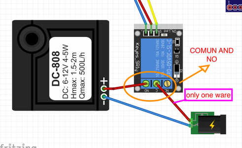

Step 7: Water Pump Connection
You must be careful, remember that the relay is a switch and that you only need one cable or phase of the source, when it is activated it allows the current to pass, the cable is connected to common and normally open

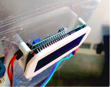

Step 8: Common Assembly 3d Printing in Acrylic
I designed this piece to give greater stability to the reading on the LCD, in acrylic it looks very good so you can use it. Use M3 and M4 screws to adjust.
This is ideal for placing the robot in the patio so that the plants germinate in 5 days.
download in the link.
