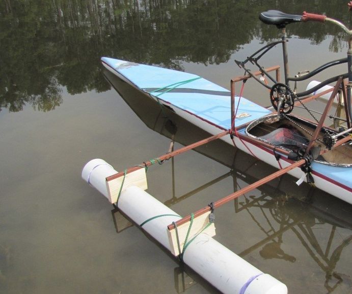

Step 13: Pontoon Flotation
• Cut a 10 ft. length into two 5 ft. lengths. Placed empty two liter soft drink bottles inside the pipe for “emergency” flotation in-case a pipe started leaking.
• Glued PVC end caps to the pipes.
• Place empty 2 L bottles inside before sealing
• Strapped the pipe pontoons to the metal frame as “out riggers”.
(Used 4 cords at a total cost of $6)
Step 14: Attaching Flotation
(Used 3 cords for a total cost of approximately $6).
• Attached the pontoons with short bungee cords (4 each)

My mom and dad helped me get the water bike onto the lake for the initial testing.
• Performed a flotation test before getting on the water bike.
• Gradually, started pedaling the bike to allow the craft to build up speed.
• Unfortunately after going about 50 yards the 90 degree gear broke loose and would not turn the propeller.
• Discovered that water was slowly leaking in through the bottom of the kayak where the rudder was attached and through a small crack at the very tip end of the kayak.

24. March 25, 2014. Broke the gear box down and discovered that the rotational direction caused the attachment nut for the beveled gear. To “unscrew”.
25. Path forward based on the first test run results:
• Use a propeller that will allow rotation in the counterclockwise direction to “push” the waterbike and prevent the attachment nut for the bevel gear from unscrewing.
• (Purchased a model airplane propeller from Landing Products in California. (counter-rotation) ( $19.95 + shipping). This propeller is a 16:14 pitch (16 inch diameter with one rotation pushes the water 14 inches).
• Seal around the rudder with silicone
• Duct tape the end of the kayak
• Perform a second test run
