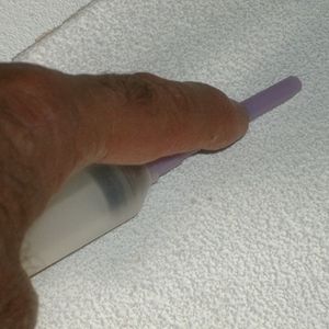

It's the case we are interested in. The syringe is not needed for this project. Syringes make good tools for precise application of lubricating oil. Without the needles, they can also be used for fine extrusion of silicone rubber. (The needles are too narrow to force the silicone through.) If you discard the needle tips, just be careful. They are very sharp.

Since the tip protector is small and hard to hold while sanding, I set it in the protective syringe body cover and hold it in place with the syringe (without the needle) from inside.
To sand the curve, use a forward and backward motion, with a little extra wrist action. Make sure the curve has no flat spots and that both sides are sanded with the same curve. Once you get the arm and wrist motion down, it becomes almost automatic.
Use course sandpaper first, then medium, and then fine. Remove edge burrs with a very sharp X-acto craft knife, or something similarly precise.
