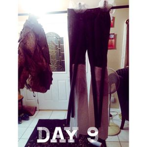

I was looking for a way to challenge myself by creating something out of this world. The Groot costume idea came as a challenge to me. My peers said I would not be able to re-create such an intense character before Halloween. There was a lot of trial and error with this costume since there is no tutorial on how to make a huge alien tree. I am extremely happy with the results. This costume took me 20 days to make it. I think I will have paint stains for a very long time.
These are the materials that I used to make the costume:

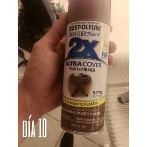

EVA foam, insulation foam, different tones of brown spray paint, plastic dip, tacky glue, paper, dremel machine, a painters suit, 8 pieces of 4x8 wood, and cement glue.
Step by step instructions:

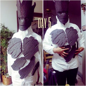

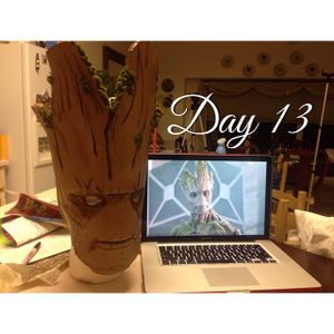

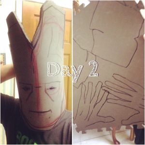

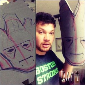

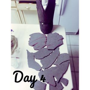

1. Cut the eva foam into desired shape.

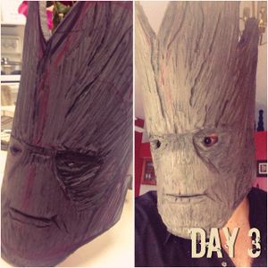

2. Use the dremel to create the wood appearance.
3. Spray plastic dip (2 layers)

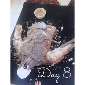

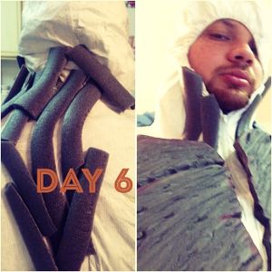

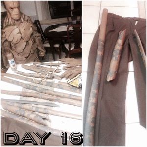

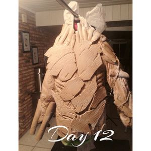

4. Mix the paper and tacky glue together and place it on top of eva foam and insulation pipes
5. Let it dry!

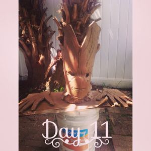

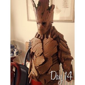

6. Use different tones of brown spray paint

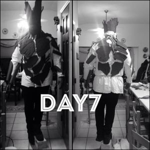

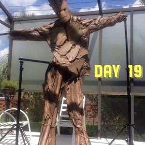

7. Cement glue the foam pieces on painters suit.

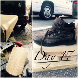

*For the feet, I used the 4x8 pieces and drilled them together and then drilled them to my shoes (it made me about 7' 5 feet tall)

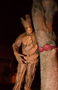

So far I have received tons of great feedback and reactions, such as, "You did a really good job" "Incredible...." "So impressed!" The best part is when I went for a test walk outside of my neighborhood. Cars stop and took pictures with their cellphones and a family stopped and wanted to take pictures with me and their children.
