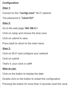

On the first boot, the ESP32 will start in AP mode.
You’ll need to configure your Wi-Fi network and time zone.
The ESP32 will then restart, connect to Wi-Fi, and get the time automatically.
The push button controls:
  1. Single click: Show the date
  2. Double click: Open configuration page
  3. Long press: Reset the clock
If you don’t reset the clock on each boot, it will automatically reconnect to Wi-Fi.
