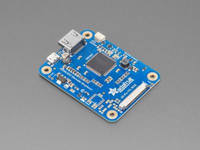

Display Driver ~ $30

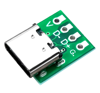

USB-C Port ~ $2 (for 5 pieces, but you'll only need one)

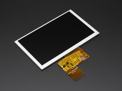

The most important part of this project was the display. I didn't want the unit to be very big, since that would defeat the purpose. So while looking through my box with displays I found a 5-inch 40-pin TTL display I had lying around and that just felt like the right size.
The display section consists of 2 sides, a top and a bottom half. The display unit is sandwiched in between these two halves to keep it safe and secure. The back half has a slit cut out of it for the display ribbon cable to pass through. One thing to keep note of is any components soldered on the ribbon cable. You don't want these to be under tension as that may lead to the solder pads ripping off, breaking the display. The cable bends right above the soldered-on parts and makes an arc to the driver board below them.

With the display construction looking good I moved on to the part that would bind it all together. This was a little more complex. The body needed multiple cutouts. Had a large amount of overhang and the display driver board needed to be mounted in the correct place based on the ribbon cable. Mounting the driver board was the most important part of the whole so that's where I started.
First I want to thank Adafruit for their superb documentation. Without it, this part would have been a lot more difficult. How did that documentation come into play? Well, they did not only show me the correct location for the mounting holes but also how far the center of the ribbon cable connector was from the edge. I measured how far the edge of the ribbon cable was from the edge of the display, and how wide the ribbon cable was. With this information, I could position the driver board in the right place, first time.

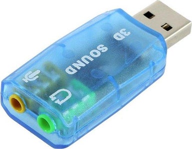

With the display diver board in the right location, it was only a matter of leaving enough room for the other electronics and making cut-outs for the ports in the right location. I left some room for the speakers at the front and added the required standoffs for the bottom cover. The USB-C port is connected to a USB to 3.5mm jack adapter and the headphone jack of the adapter feeds into the audio AMP that drives the speakers. I chose USB audio because I wanted compatibility with the greatest amount of devices, and not all devices have a 3.5mm jack nowadays. A nifty thing about the audio AMP is that it works with 2.4-5v input. Because of this, I can power the AMP with the spare 3.3V out on the display driver.
As you can see, I've used a lot of hot glue. This is because the parts apart from the display driver board didn't have any mounting holes. Yes, I could have made mounting brackets for each part, like I did with the USB breakout. I didn't because I didn't think it was worth the effort and the port actually needed it so it would stay in place when plugging in the USB cable.
