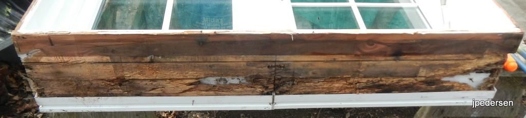

The bottom and lower sides were in really bad shape, the bottom of the casing was the worst and would have to be completely replaced.
The double glazed windows seals were intact with no fogging at all.

As I was disassembling the window casing I found some moss. The bottom was where the moss came from, it was hidden between the vinyl frame and the wood casing.
Removal of the rotted wood and repair of the lightly damaged wood.

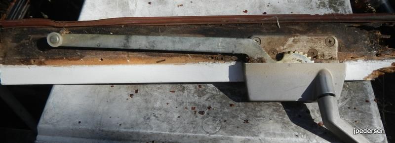

Carefully disassemble the housing for the window crank, assess what is needed to fix it.
Remove extra piece of casing with it.
Remove bottom part of casing, this was a bit tricky because the casing frame was assembled with 2 inch long crown staples.
Noted how window crank assembly was installed and how it worked.
Determined which pieces could be repaired and which pieces had to be replaced.

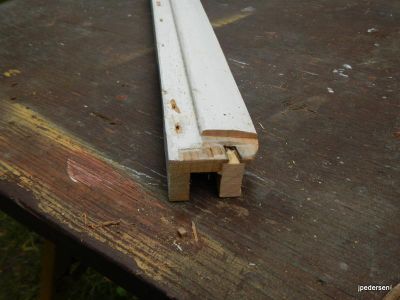

After removing the bottom casing of the window, I then worked on repairing the side pieces of the casing.
First, I carefully removed the really rotted pieces of the lower ends. Picked pieces out with needle nose pliers and a screwdriver.
Second, let it dry for several days.
Third, after it was thoroughly dry, I stood window upside down so I could apply the wood hardener following the directions, I carefully poured it into the rotted section some parts, I also used a small brush to get complete coverage of some pieces. Let it dry overnight and reapplied, I did this three times. It is really quite amazing how well this product works.
Fourth, then I mixed up some of the wood epoxy and applied it. Sanded the next day and then applied a little bit more epoxy to fill any gaps. Sorry I only have one picture where the epoxy had been applied.
The above procedure was done for any pieces that I needed to repair.

The crank mechanism was attached to the new wood casing. The window hinges were reattached to the window frame.
Hooking the window back up to the crank, was a bit tricky, because you needed to have the crank arm in a certain position so that you could attach it to the bottom of the window. This took a bit of trial and error to get it right.
That done the repaired wooden window crank mechanism cover, could be reinstalled it was nailed in place with some long finishing nails.
