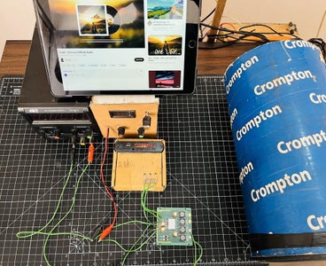

Testing Units:
30V 10A Power Supply
5V 2A isolated Power Supply
Subwoofer 200W
Heatsink and active cooling

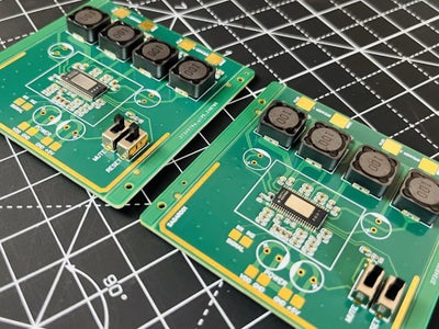

Step 4: PCB Design:
The board is designed on a 4 Layer PCB stackup to minimize the noise and any humming in the circuit ground plane is used underneath the main signal layer. The proper stackup of the PCB is defined as Signal/GND/5V/Signal. The output section is routed away from the input section so that any backpropagation and signal crossover do not happen in the PCB. As per datasheet the decoupling capacitors are used near to main IC, near to power pins so any noise in the input power supply signal can be eliminated. I used the PCBWAY SMT assembly process to get the soldering and part placement done easily.
To route the main input audio signal 50 ohm line is used on the signal layer and to route the output section polygon planes are used. Vias at different points in signal and power planes are avoided to reduce the noise. The best practice to route the output section with via’s is to use different via’s with the same track in this way the current is distributed in the different tracks and propagation of signal is possible easily. I have stitched the signal layer copper pour with the ground plane to reduce the EMI problems in the circuit. Download all the design files from here.
Step 5: Connection and Power ON:
Two slide switches can be seen on the top layer of the board. One is to reset the IC, and one is used as a mute switch. Reset can be turned off after powering the IC, in this way any glitches in the output can be eliminated. CMute switches are connected to a MOSFET which is controlling the Mute pin of the IC, this is used to power off the amplifier from active output mode.

Step 6: Working and Testing:
Here I have attached a video, here you can see the raw audio performance. The testing setup includes a DSP unit, 24V 10A power supply and 200W subwoofer. Test at 70% volume the amplifier performs best and produces very low heat which can be dissipated by a 40x30mm passive heat sink.
