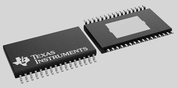

I am here with my own Class D amplifier as promised in the last articles. Because Class D amplifiers are used in audio equipment’s on large scale. So, I tried to design myself to understand the working principle and classification of integrated circuits used in Class D. As mentioned in previous article I am using breadboard compatible IC shield to try different components. I have TPA3118 series IC which can output a maximum of 60watt in bridge mode. You can also use this in stereo mode to output 30 watts per channel. Here I am sharing the datasheet with you.
Step 2: TPA3118D2 and Family:
The TPA31xxD2 series are stereo efficient, digital amplifier power stage for driving speakers up to 100 W / 2 Ω in mono. The high efficiency of the TPA3130D2 allows it to do 2 × 15 W without external heat sink on a single layer PCB. The TPA3118D2 can even run 2 × 30 W / 8 Ω without heat sink on a dual layer PCB. If even higher power is needed the TPA3116D2 does 2 × 50 W / 4 Ω with a small heat-sink attached to its top side Power PAD. All three devices share the same footprint enabling a single PCB to be used across different power levels.

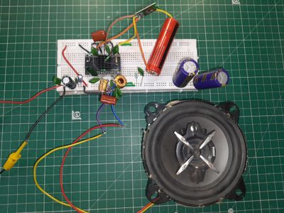

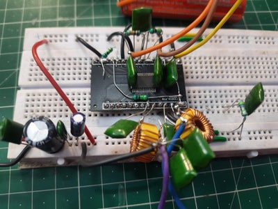

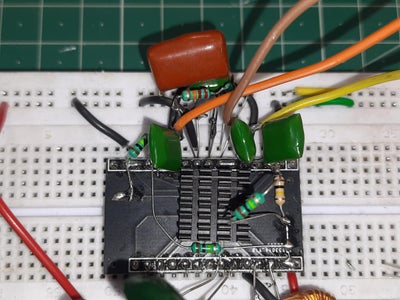

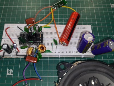

Step 4: Breadboard Circuit:

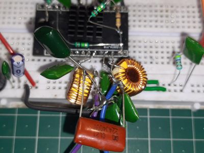

Breadboard schematics is designed as per circuit diagram shown above. I am using only 1 channel with a max output of 30watts. Which is used to drive one speaker only. All the circuitry is supplied with 12v @2amps.

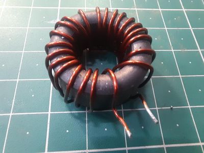

Step 5: Coil (L-C Filter Setup):
In the circuit 10uh is the recommended value of the inductor. But we can use 100uh to 330uh inductor in combination with a 220nf to 1uf capacitor for a better frequency response from the LC filter. This will reduce the overall noise and give a stable signal to speaker to tune accordingly with low, mid and high frequencies.

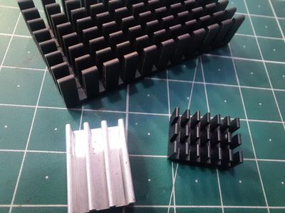

Step 6: Heatsink Assembly:
Because we are testing this amplifier in raw conditions with variable power supply unit and gain resistors. A heatsink is mandatory for that, IC may be generated heat in low load resistance conditions. This 3118d2 can output a maximum of 60watts or 30watt per channel without heatsink.

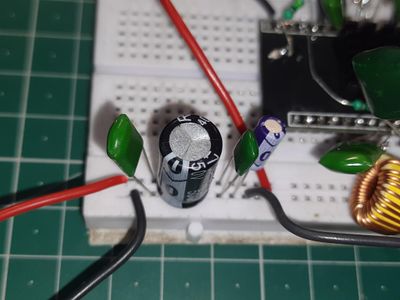

Step 7: Power Supply:
The working of class D amplifiers are discussed in previous article you can see that from here. Because we are using LC filter to reduce the square PWM into audible signal. That’s why a filtered power supply is recommended with these class D amplifiers. Either we can use a SMPS or High filtered DC supply for power input.

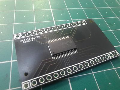

Step 8: JLCPCB Assembled PCB:
At my place here in INDIA, Class D integrated circuits are not sold separately. If I want to play with Class d then I have to buy a full amplifier system. Which will cost me more and out of the interested area. That’s why I planned to go with PCBA service of JLCPCB. Previously I designed this breadboard compatible shield on which I am testing this amplifier.
Step 9: Working:
I mounted everything on a small piece of breadboard. And after testing for an hour, I found- At higher volumes amplifier is turning off with a pop sound. This is because of power limit and gain resistor setup. I don’t have ceramic capacitors of recommended values so I used polyester film low value capacitors.
If you are using this amplifier in stereo channel then same value resistors, capacitors and inductors are required on the output stage. Inductor coils matters a lot in this circuit, higher the value greater will be the frequency response.
