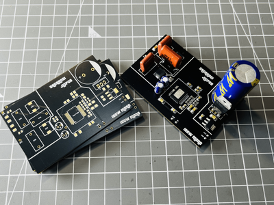

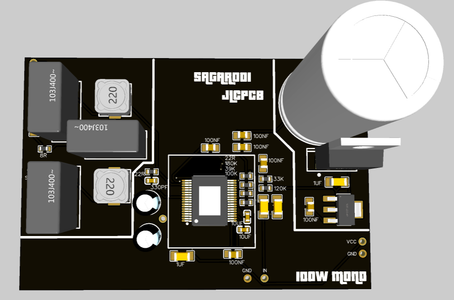

Step 4: PCB Designs and Gerber Files:
In the amplifiers the common problem is of noise and humming. This may come due to any external power line fluctuation or may be due to any damaged and non-specified component. To keep the noise as low as possible there are few design consideration you should keep in mind.
Keep all the power lines away from the input signal tracks. And make sure to cover the whole PCB with GND net copper area. Keep all the ceramic capacitor away from the main IC they may produce oscillations. Use power line filtration capacitor at different places in the PCB plane.
If you want to use the same designs as mine then download the Gerber and SMT assembly files from here. You can upload these files to JLCPCB and order for the same PCB in just $2 for 5pcs. And SMT assembly service is starting from just $8 which in a total may cost $50 including assembly and components cost.

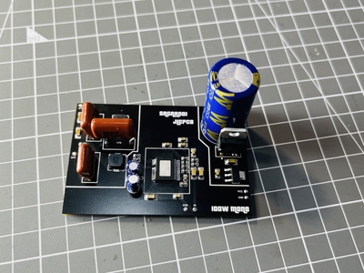

Step 5: Hand Assembly:
If you want to assemble the PCB by hand then the only solution is to use Stencil with it. Because there are too many small components and for even flow of solder paste stencil is required. JLCPCB is the one stop solution of all of your prototyping needs, you can explore the services like: PCB assembly (PCBA), Stencil, 3D printing services and multilayer ultra-precision PCB.
I use the same method I have all the components lane around and I used stencil with the PCB. Then I solder the PCB on a hot plate. In the PCB I used FR4 material, ENIG finishing and black colour with 1.6mm thickness.

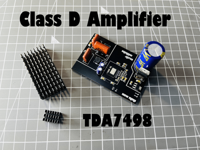

Step 6: Heatsink and Power SMPS:
This is class D IC which can be operated very efficiently on low voltage easily without any power dissipation. but for high output like 100watts, an external cooling system is required. Either you can use a small heatsink with small CPU fan or a little big heatsink. This will increase the overall stability and prevent any short circuit in the IC.
And for the power supply linear power supplies (Transformer with rectifier) is not recommended due to high ripple factor. Use any single power SMPS power supply which can supply at least 5amps at 24volts.
Step 7: Working and Performance of Amplifier:
I paired the amplifier with a Bluetooth and hooked up the power supply. This time my circuit is working very well. In future I may improve the circuit components like instead of SMT filtering circuit I can use Trough hole components. Which also reduce the overall noise factor. The amplifier is fully silent when there is no input and it can handle a 100w subwoofer very well. You can see all the performance in the video given above.
