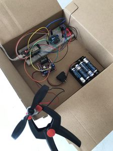

Step 5: Assembly Up and Running!
Here's a video of the assembly. The fan is programmed to start if the temperature goes above 26 °C and will reach its maximum speed at 30 °C.
