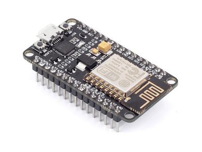

  1. Raspberry Pi Pico
  2. NodeMCU
Step 1: Wiring/Connections
To connect the Raspberry Pi Pico to NodeMCU
  1. Connect D1 of NodeMCU to GP8 of Raspberry PI Pico
  2. Connect D2 of NodeMCU to GP9 of Raspberry PI Pico
  3. Connect GND line on both for a common ground
Check the above image to cross-check your connections. No need to worry here as the connections are simple.
