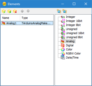

Step 8: In Visuino: Add Analog Channels to the Make Structure Component
  1. Click on the "Tools" button of the MakeStructure1 component (Picture 1) to open the "Elements" editor (Picture 2)
  2. In the "Elements" editor select the “Analog” element on the right, and then clickon the "+" button on the left (Picture 2) to add Analog element (Picture 3)
  3. Close the "Elements" editor.
