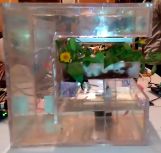

Step 2: The Aquarium and Grow Bed

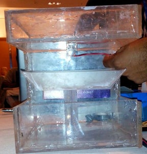

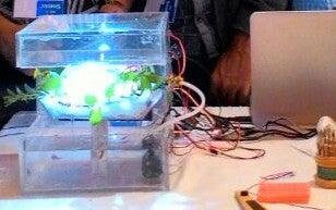

The build in this instructable is an open bottom aquarium with an unique cantilever beam that sports the fishes swimming above the plants, but you could simply build any type of aquarium or upgrade your existing one.
The Aquarium is built using transparent acrylic sheets. you could build with the dimensions that match your desktop or living room. the one in the images is built to be of around the size of an ipad, that would fit well on your desk beside your laptop.
  • Cut the acrylic sheets according to your design
  • Temporarily fix the sheets in pairs using a tape and apply acrylic cement
  • wait for the acrylic cement to harden and add another coat of silicon sealant
To learn more on building an aquarium with acrylic
Once you have completed the aquarium build, test for any leaks and use the remaining acrylic sheets to build a grow bed. Make sure you create holes/outlets to the grow-bed.
Add the mat sponge to the lower layer and place the aqua-clay above it. You can add you plants to this layer.
Add piping from the grow-bed to the aquarium where you will place your dc pump.
The grow bed needs to be above the water opening so that the filtered water can run down, be creative and you can create a beautiful waterfall.

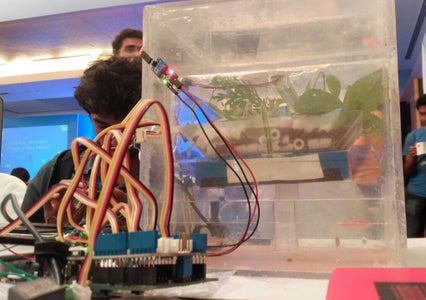

Connect the Seed grove kit board to the Galileo board and add the following:
  • 4 relays
  • Soil moisture sensor
  • light sensor
  • waterlevel sensor
  • tank heater(i used a peltier here)
  • temperature sensor
  • (optional ph sensor)
  • Add the wifi module and configure wifi connectivity.

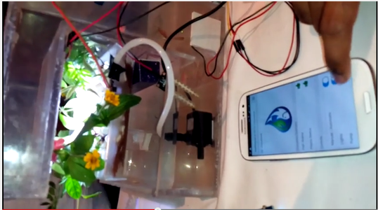

Add the Water pump to the aquarium where you placed the piping and wire the pump through a relay.
Connect the lighting above the plants and add the heater to the tank, run their wiring through another relay.
Use the soil moisture sensor to measure the water content in the growbed. Add the temperature sensor and ambient light sensor to the tank. Connect them to the seed kit.
Create a simple feeder as shown in the video below and run the wiring through the relay. you can use acrylic to build the feeder instead of the steel shown in the video.

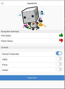

Write an app using the intel XDK to connect to the board and actuate the relays.
Start with the HTML5 companion app, you can use the data from the cloud stored earlier to plot all the historical readings. Also derive metrics related to the tank. The samples also show the socket communication examples, use them to actuate the relays. Find the screenshot of the app built for iAquadesk. the possibilities are endless.
Use the app to remotely monitor and control the system.
The working E2E iAquaDesk:
