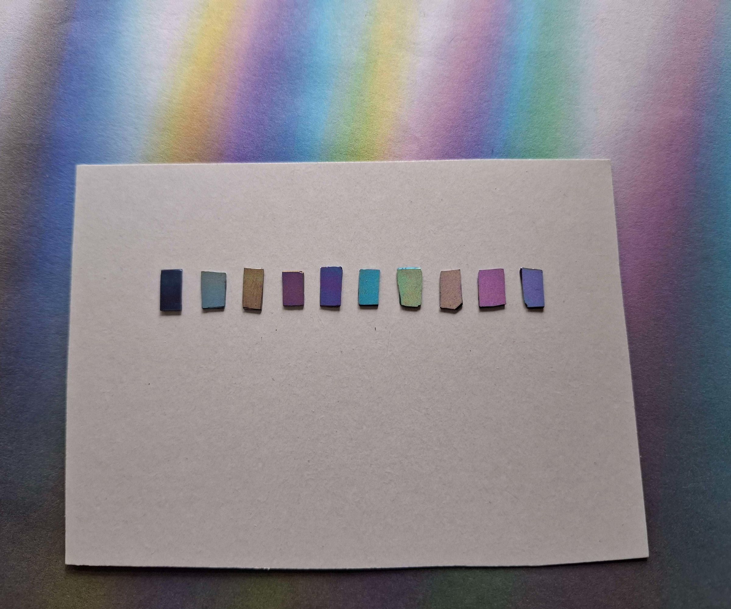

Pick away any remaining pieces of lead-frame/plastic and find the dies. If there is lots of plastic residue remaining on the dies you can scratch it off with plastic tweezers (some acetone may help). Rinse the dies a final time to remove any large debris.
Step 3: Results
I arranged some dies on a microscope slide, these are (L→R): Xbox 360 GPU - Revised Y1 (90nm, 2005), NVIDIA GeForce 7650 GS GPU - G73B (80 nm, 2006), Intel GM45 Mobile Chipset (65nm, 2008), two unknown devices (!), and an ATMEGA16U2 Microcontroller (350nm, 2010). Interestingly, you can see the die size gradually decreasing in the first three devices as the process technology evolves.
