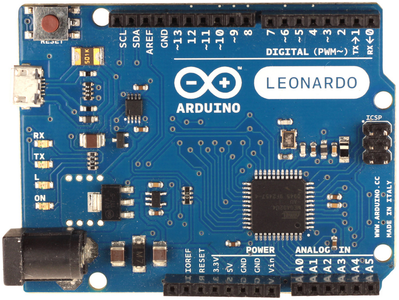

2. Boards that work out of the box
  1. Arduino Leonardo: Classic Arduino size
  2. Arduino Micro: Narrow profile, sturdy Micro-USB connector
  3. Arduino Pro Micro / clones: Cheapest and tiniest—perfect for mounting inside a PC case

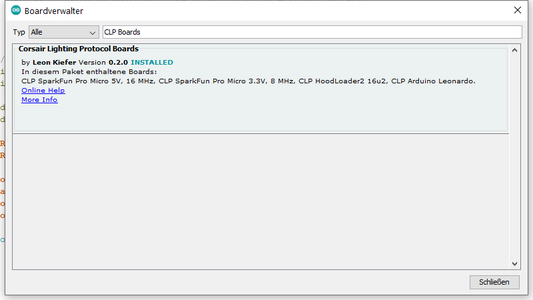

Open the Arduino IDE and go to File > Preferences > Additional Board URLs and add following URL to the list:
https://raw.githubusercontent.com/Legion2/CorsairLightingProtocolBoards/master/package_Legion2_CorsairLightingProtocolBoards_index.json
Next open the Boards Manager and search for "CLP" and install it.
In tools > Board > Corsair Lithing Protocol Boards select "CLP Arduino Leonardo"
Open the example: File > Examples > Corsair Lighting Protocol > LightingNodePRO
Choose the correct device: Tools > Device > Lighting Node PRO
Choose the correct COM-Port and Upload the example.
